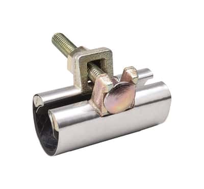

Good evening everyone, I hear that you can remove these torsion bars with a 3/4 in. stainless steel pipe repair clamp. Does anyone know if this will work?
Link doesn't work for some reason. Maybe because it's the Google page. Here's the sites link.
B&K 3/4 in. Galvanized 430 Stainless Steel Pipe Repair Clamp Mfr# 160-604 - Ace Hardware
It might work if the bar isn't real tight. It might not hold up to a lot of hammering.
My link doesn't work either. Had to copy and paste the link text to get there. Here's the pic.
How the hell are you going to get the clamp over the bar? If it's flimsy enough to spring right open to go over the bar it will be too flimsy to work. There's nothing much to hammer against either. I just made one with a couple of pieces of timber, notched out to fit the bar, and then a couple of bolts through to clamp the timber together.

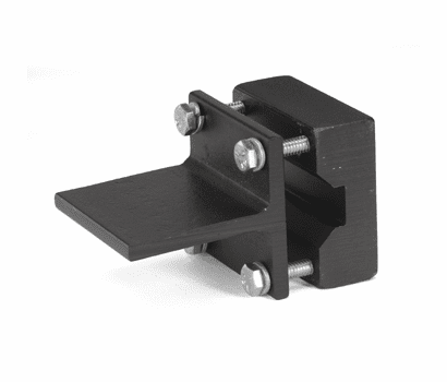

Unless they haven’t been been disturbed for 50 years there is a good chance just getting the suspension in full droop (remove bump stop) and giving them a good tug will probably get them out. But if they weren’t grease you may need that Mancini tool.
