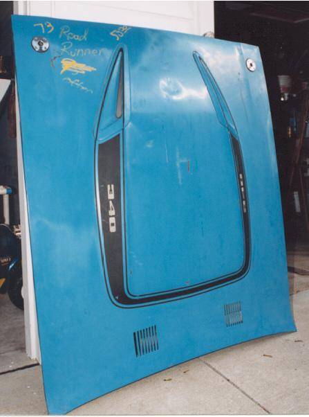

The hoods don't interchange without some significant reshaping at the front corners. That's where Plymouth decided to start the flare that continues onto the fenders, so the "L" shapes on each front corner need to be flattened and filled. You can see what I mean in this pic:
I think that hood looks way better on a 71/72 than it does on a 73/74, btw. It's a hood/grille combo that totally works.
