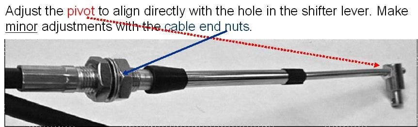

Here's a tip I learned the hard way. If you need to make minor adjustments, align the cable pivot piece perfectly in line with the lever hole in whatever gear the manufacturer recommends. Make your minor adjustments at the cable sheath, not the the pivot piece.
Shorthouse you share some great information, that has given me a ray of hope. As I look at the picture of your cable, it is different then mine. Where my cable screws into the shifter there is a brass block, not the double nut and stud as shown. The brass block is threaded, so I may be able to get some adjustment there. Are you saying I should remove the entire cable to make these adjustments? I will have to wait until Monday to try this ide as my car is in my shop at my job. I am grateful for your input. God bless you!
I found this picture that looks more like my set up, but it confirms your idea.
I screwed up. I see what you mean by where the adjustment is on the turbo action shifter. Duh, I made an assumption they were all near the same. My picture was of a different style cable end that goes into the transmission lever for several other brand shifters. That's what I'm used to.
Regardless, once the pivot piece is in the transmission shift lever as instructed, all adjustments are made up top at the shifter "terminal block". The difference I see is the shield is fixed at both ends so there is no adjustment there. The instruction talk about "total travel". They specify that the total travel should be between 3 and 3.25 inches. There is that 1/8 inch you are dealing with. You are on the right path. The threaded block (terminal block is their term) is where your're going to get your correct adjustment. I'm sure this will work but if for some reason you cannot get the right adjustment under any circumstances, we'll revisit the shift lever ratio issue.
