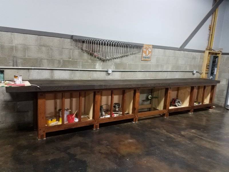

Chestnut workbench in the making.

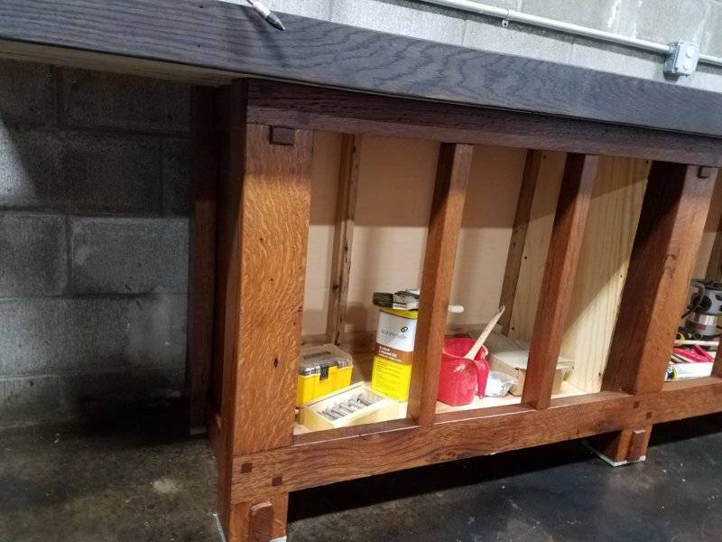

I thought they might be plugs. I bought an Steelcity mortising tool years ago for doing plugs. I think I paid 200 on sale when I bought my 22" drum sander.

Unfortunately I just realized something that will slow progress!! I've been wanting to acid stain my garage floor so the worst thing I can do is plop an immovable object right in the way. The pros say wait for less humid weather so looks like I better hold off for a bit. I might just throw the pieces in there and hold off on the drawers and cabinets until it's permanently in place.

With my floor finally finished I'm back to work on the bench. Here it is where it will stay with it joined as one and the top installed. Knowing the floor will sweat if the doors are open I fastened plastic to the bottom of the legs to isolate them.... I'll need to anchor it down now lol.
I went ahead and stained the top with Ebony so it won't show oil stains as bad and will likely just give it an oil finish. The cabinets are only stained, I'll get some clear on them asap then start the doors and drawers. Placement worked out awesome, the boiler lines come threw the wall in the center cabinet so the pump, strainer, etc will all be hidden within.
Got the base is cleared in Satin Polyurethane and the top sealed up with Linseed oil, pretty happy with the finish. We'll see how the Linseed works out, I didn't want something that would chip, crack or peel so oil seamed like the only option. I'm thinking the best thing to do would be to cut some work tops out of masonite for jobs that will tear it up and keep them on hand? Once I get caught up on my wife's ever growing list I'll start the drawers and doors.
Looks good.
Now time to get it dirty.
Needs a vise.
That flame/wood grain really looks with that oil. And in a Stickley style no less, nice, nice, nice

You know now that you mentioned it next time I look at them I'll probably give it a whack lol. I believe that wall will get a peg board in the future but not the crappy press board ones you normally see, we bought a steel one at work that kicks ***... likely order a few of them.
You know I've always really disliked Oak or any other wood with similar boring grain but if it's quarter sawn like this it's probably my favorite.
