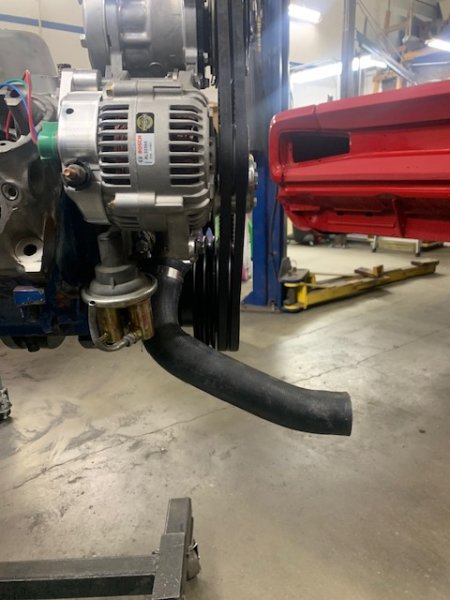

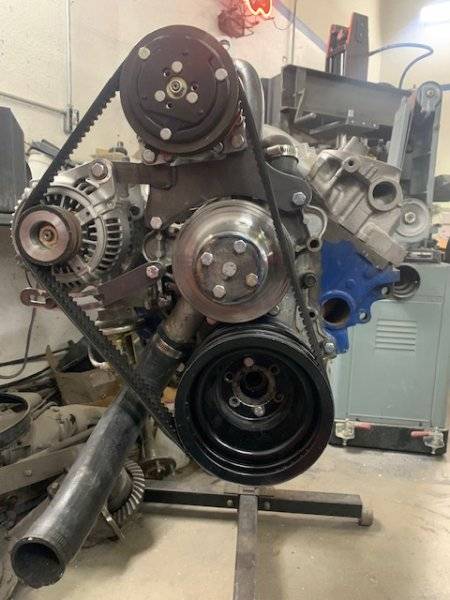

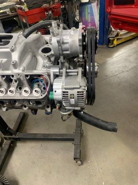

My solution... Just moved this from my spare engine mock up to the car today... Toyota Land Cruiser alternator... Max output, 110 Amps, Max output at idle? 95 amps...
