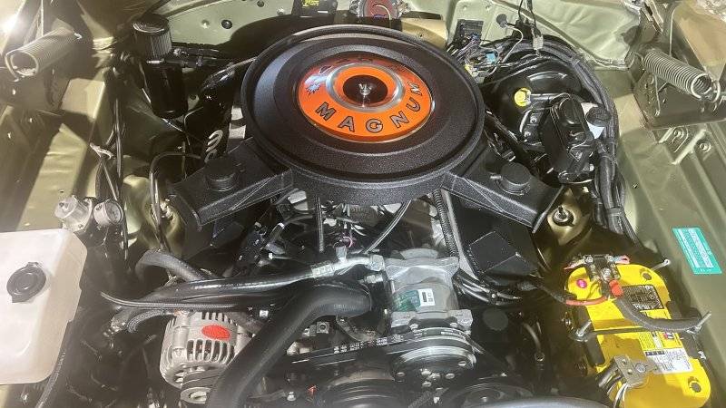

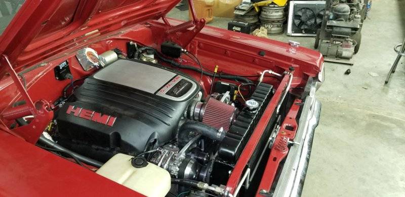

I used the Vintage Auto Air in the Convertible, but using the sanden SD-7 compressor that comes with the Billet Specialities Tru-Track system.
I like just about everything except the way they route the lines under the fender. Some might like that the lines are somewhat hidden?
The Condenser and dryer are a nice setup that fits well on front of the radiator.
The electronic controls in the stock location are nice too.

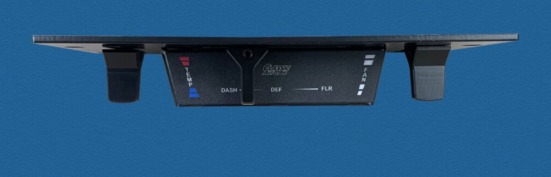

I caved and bought the Classic Auto kit. I have heard it performs better, and for me the layout of the controls looked way better than how the Vintage Auto Air unit was set up.

On my GTX, I'm going to try the Classic Auto Air system. It's an original V-Code car, so of course, it wasn't available with a/c. The CAA controls resemble the stock non-a/c controls. I wasn't too keen on that plate VA wants you to use on the firewall and since I was going for more of a dealer installed a/c look, and running the hoses and lines under the fender wasn't going to work either.
