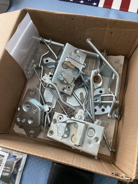

Just wanted to throw the name of this zinc plating co. out here for people in and around NJ. Alcaro and Alcaro plating in Montclair NJ. I’ve have used them for years. They do both clear and gold di chromate zinc plating.
I glass bead any parts before I give them the parts, quick turn around and very reasonable. This picture of what I picked up today was 75 bucks.
Freshly plated parts really take an average resto to the next level.... Details are everything...
