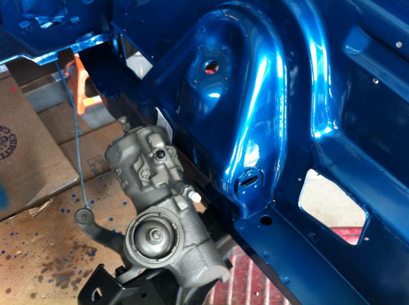

Don't recall when I pulled the box what the clearance was between the box and the inner fender panel...The business card is tight...is this normal?
Thanks..
For what it's worth, my `66 has about 1/4". I don't know that you will get that much out of the three mounting bolts, but that's what I would try 1st...loosening the bolts and seeing if I can shift it inboard any. If not, you can try loosening the four 'K' frame bolts and seeing if it will move any to the right. :dontknow:

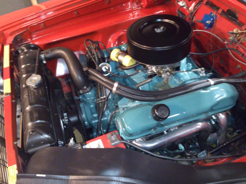

my '63 is real tight.. (only pic I can get to you...Fast!)
