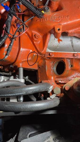

Hello, I am putting in a progression distributor and am having a clearance issue. In the picture enclosed I circled a ridge in the cylinder head causing the problem. Can I grind that down? Thank you for your help.
No water or port very near to that. I would not worry about
a .050 to .100 cut. But I have never had to do that even with a
mag if the unit is clocked in correctly. You can move wires
if that helps for clearance for unit.

Thank you for your reply GTX John. Here is a link to the distributor Progression Ignition.
I have cleared everything else out of the way. It is so close to seating all the way in but the ridge in the cylinder head is blocking it from dropping all the way in.
They look very similar to a Holley hyper spark or a MSD RTR.
On my 493 with Trick Flow 240's and a MSD RTR, they had to remove .020" for clearance in that area.

That's just casting flash. Grind away and be happy.
But GTX John is right. The housing and wire positions can be changed to suit. That HAS to be done for a tach-drive distributor. No big deal.
My Progression fit perfect in that area w Stealth heads, but had to clearance the aluminum valve covers. Apparently now he's having them made just a bit smaller in diameter. I'd grind that area down, no biggie at all.

I had to grind my head a little in the same area,pertronix distributor. It will be fine.

Distributor clearance on Wedge motos has always been a issue. Either grind down the head for clearance or get a different distributor. Back in the day I sold a lot of Mallory dual points because the Accel distributors would fit.
