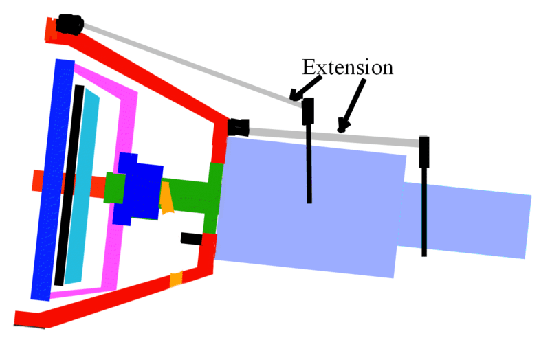

Replace top bolts tran to engine install threaded rod remove remaining bolts slid trans back and
I use B engine head bolts with the head cut off to insert in bell housing to move tranny back without losing alignment. And of course you have to use long head bolts.

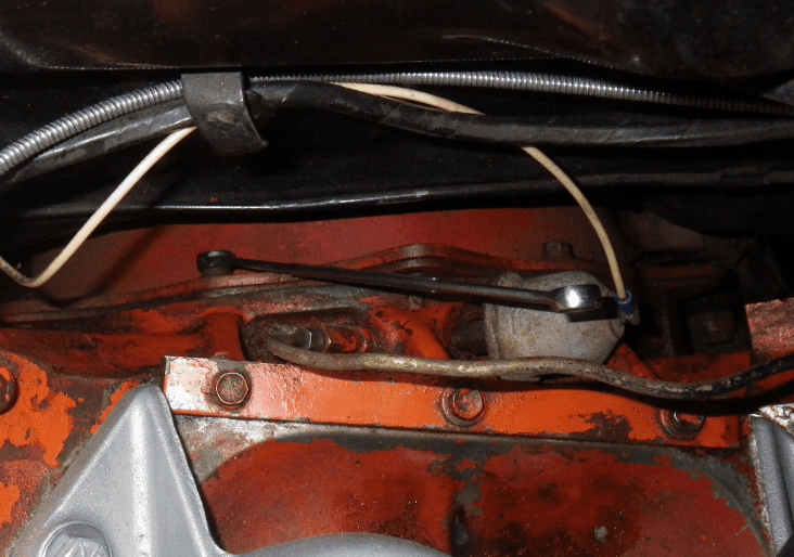

I tried Dave's suggestion of chamfering the edge of the pivot, but that still wasn't enough. Looks like I'm stuck trying to back off the bellhousing bolts, but I'm completely stymied by the top bolts. I simply cannot get anything in there to back them off. Is there some sort of trick or hack I'm not aware of?
Traditional wrenches slip and will eventually strip the bolt head, and there isn't enough room to get a ratchet-thingy in there, as the firewall is in the way.
I'm thinking I might have to drop the whole K-frame an inch or so to get a ratchet-thingy in there.

A "ratchet thingy" has me thinking you're in WAY over your head !!!
I've always been able to remove the top two bell bolts with a box end wrench from the top before lowering the trans cross member.
How about a long extension once you lower the trans crossmember?
I tried box-ended wrenches first. The ones I have just wont fit between the bolt head and the bolt cutout. Only a socket end seems to fit...but then there isn’t enough clearance for the ratchet part.
There's a "box" wrench and an "open end" wrench. A box wrench will have a head pretty damn close to a ratchet thingy socket.
