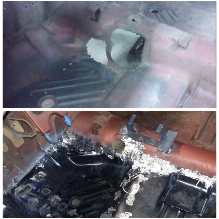

I need to replace the floor in my 70RR. Both passenger side and driver side have enough places with rot from the front seat foot wells to the rear seat foot wells that I was going to just replace the entire floor with a 1 piece full and the 2 rear foot well pieces.
Trouble is that my car is a post car, so without pulling the B-pillar I cannot use the full 1 piece without cutting it.
Driveshaft tunnel is solid.
What would you guys do? Left and right side 1/2 pans? Cut full floor in half and butt weld in car (I am a novice)? Other?
That post is something I havent had to contend with, but I just watched my son n law put in the half pan in his charger, and it worked out fine
It wasn't difficult or so it seemed he had it in about 4hrs, my guess that would be your best option, and slightly cheaper than the full floor, if i remember correctly.
It will fit.I did a one piece in a 64 dodge post and it fits.Even with just me doing it.It's all about the angle.
