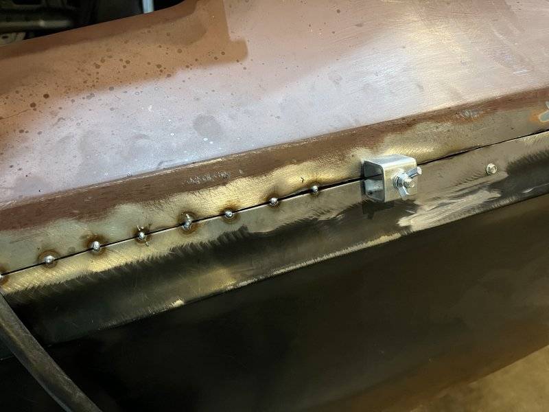

Posted this on FB on B-Body and a lot of people saw it but thought maybe not everyone uses FB. Anyway, she’s coming back to life! Passenger side coming soon as I can get to it
I used 4 inch with 5/8” arborSo you cut it then spot welded it In small sections. What are you using it small diameter cutting wheel? Due tell.
I used 4 inch with 5/8” arbor. Cut about a foot at a time trying to keep heat from building up and pushing the inside cut away overlap away just enough to clear my buttweld clamp as I worked my way down
