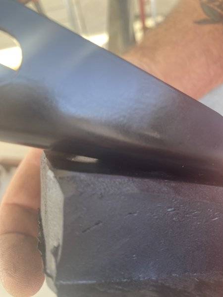

Ordered the new mounts from 440Source.
Noticing the New rubber mount isolators are not suitable unless you modify brackets.
1. Each rubber mount has the threaded bolt and a "bump" to secure proper location/alignment.
As you can see, the bump and the hole are not a match.
Tried two different sets of mounts, neither will accept the New China rubber isolator mount.
And, my visit to NAPA, my Bud told me they are all made in China now and there is a $20 re-stocking fee.

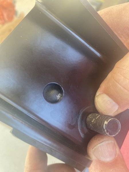

As you can see in pic #2:
There is a gap between the 2 plates.
I took one of the fixtures (Block mount) and put it on my drill Press with a Step Bit.
It enlarged the Hole but the real cure is to Elongate the hole with a Burr grinder, which I will accomplish today.
