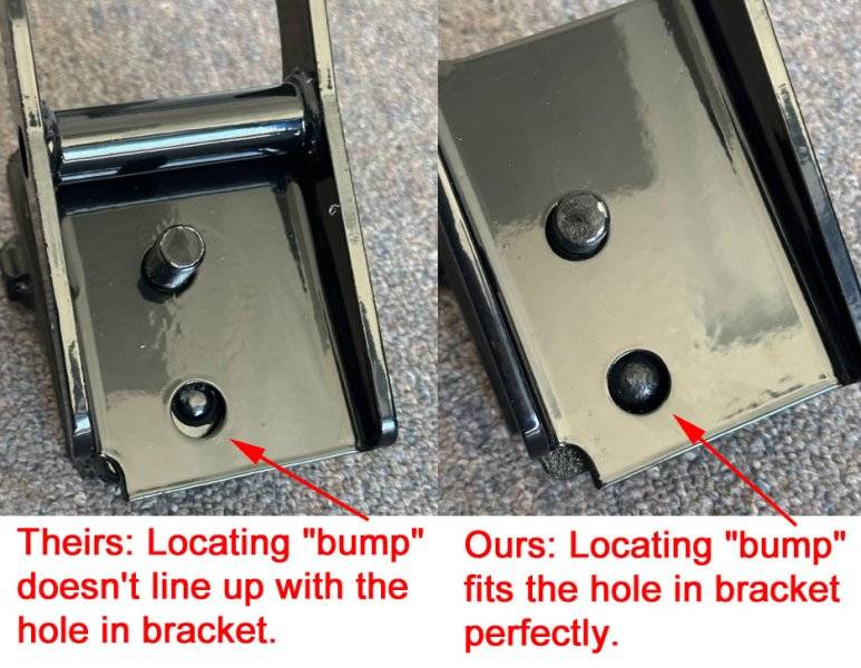

I appreciate you posting this because I've run into the same issue and didn't know if I had a bad part or the wrong part since my Charger has a 440 motor (origin unknown) instead of the original 383.
The new mounts I purchased from a vendor at Carlisle turn out to be Westar part #EM-2250 and I found the locating dimple to be about 1/4" shifted out of position towards the mounting bolt.
I'll need to take my original bracket to Napa and Carquest to compare to parts they have - but glad to know others have run into this same issue. Posting a few photos to illustrate the issue for anyone else doing this repair here: NEW MOTOR MOUNTS

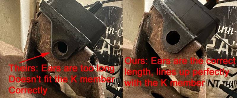

My son got some from Rock Auto, I think they were made in Korea. They were off a little, but the studs were way too long pushing against the block, and just keeping them not comfortable to settle on the K frame. Trimmed the studs down and they fit well.

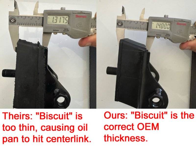

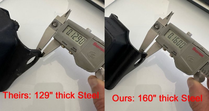

For those interested, here are the differences between the new mounts we are coming out with soon (Should have them in stock in about 4-6 weeks) and the ones currently on the market. The new part number will be "2250HEAVY" and they will likely be $29.95 each.
