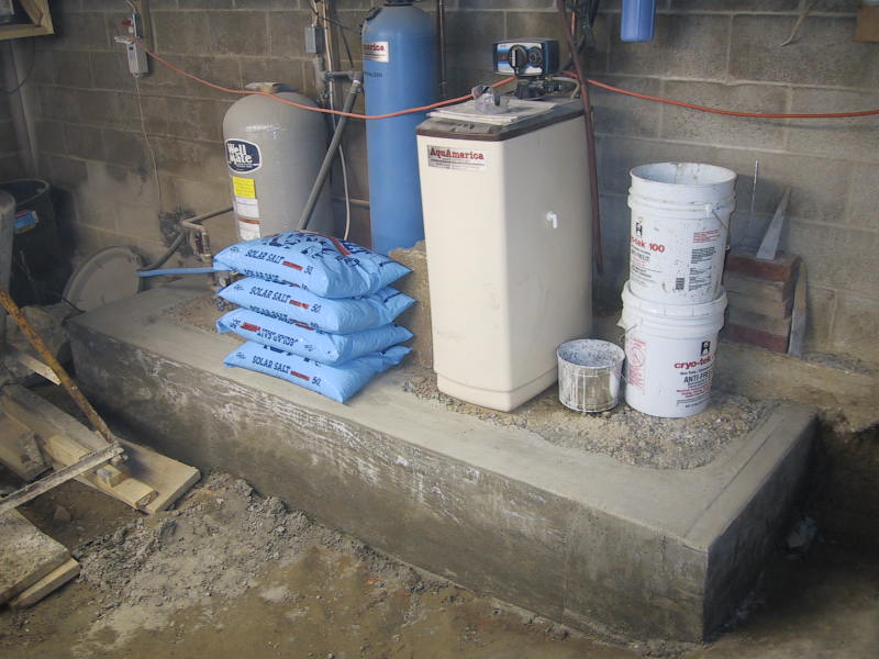

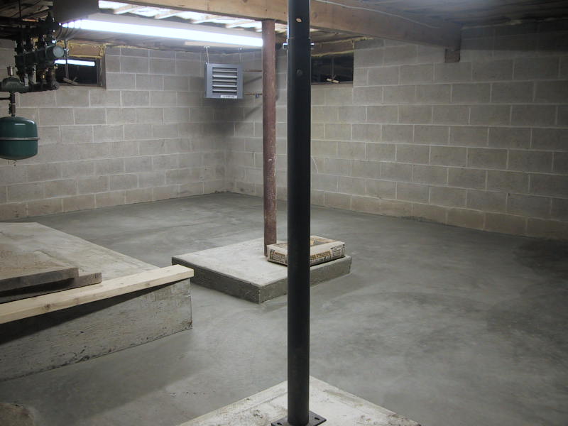

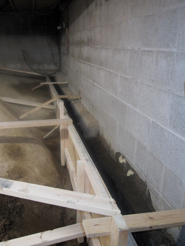

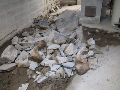

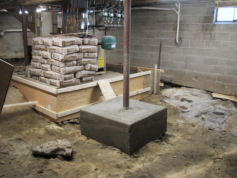

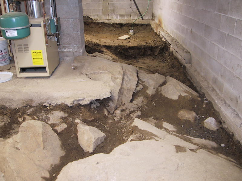

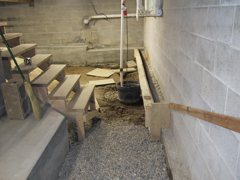

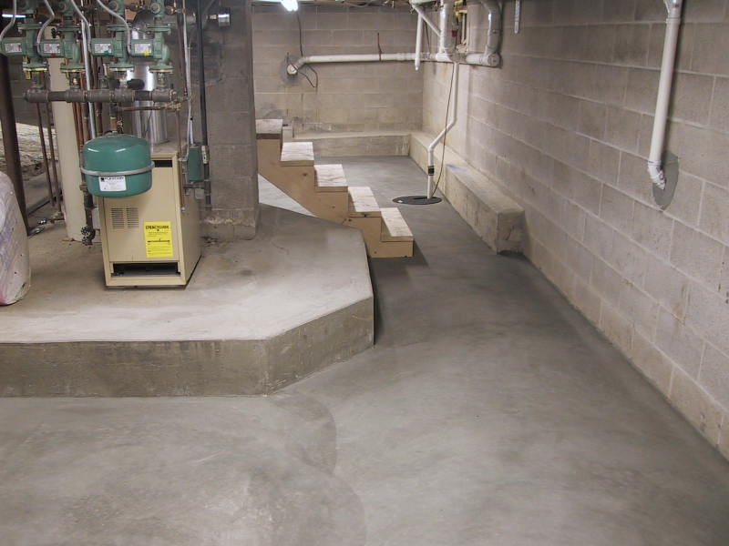

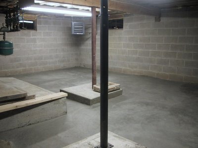

Actually, I must confess; I can relate to Steve's project as I did pretty much the same thing at our NH cottage 12 years ago Not to hijack Steve's thread, but when we bought the place, our basement was dirt & rock and my wife & I hand dug out as much as we could and lowered the dirt level about a foot and a half. Next, we had to get a commercial rock drill to drill holes in the granite and got some chemical rock cracker to break up the rocks. The rocks were later used to build a new stone wall on the shoreline. We then made forms around the furnace pad, water filter and around the foundation. I used my dad's old 1960's cement mixer and we mixed up well over 100 80 lb bags. It was friggin backbreaking job, but we got it done. next we had to wheelbarrow in a truckload of stone. When it came to pouring the floor, concrete under the deck and walkway down to the pier, I had that done professionally.

Mr Cranium, is there no end to your talents? That is a great looking basement.
