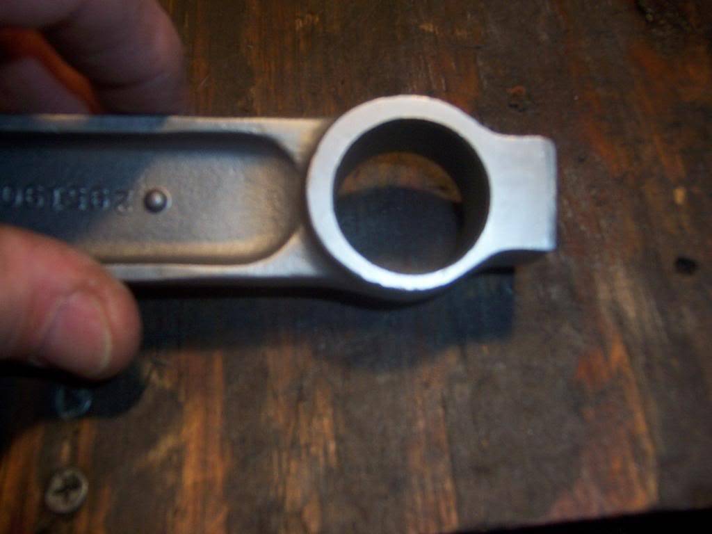

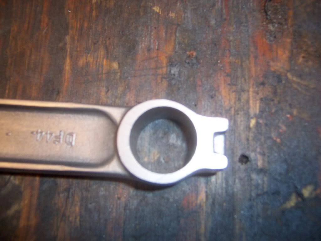

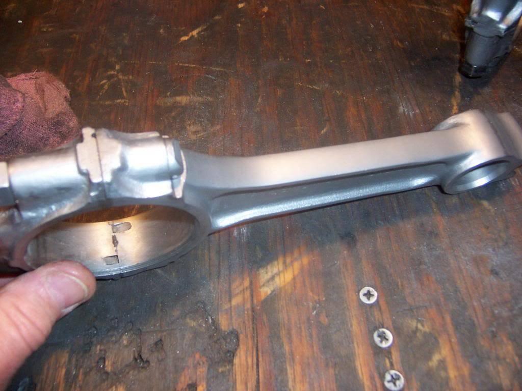

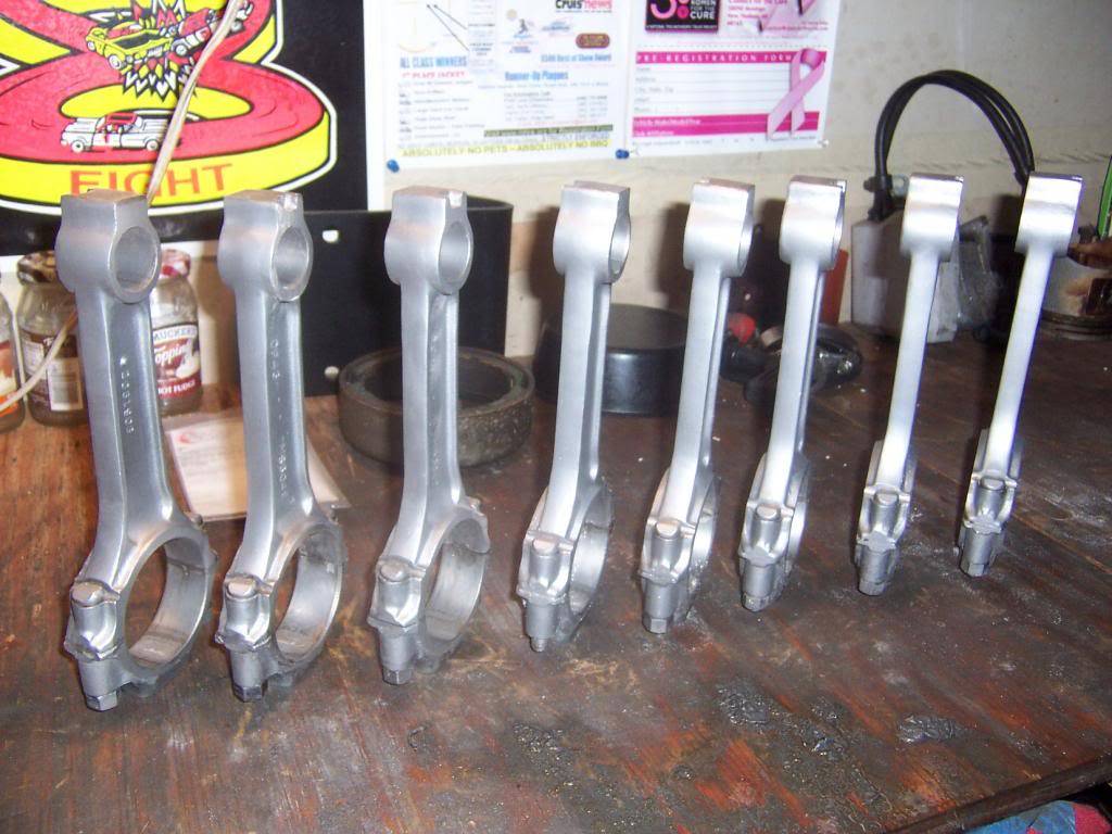

FINALLY!!! My blaster actually decided to cooperate and blast these things;after a final examination and getting the caps matched,they're off to get re-sized on Monday. With ARP bolts,of course.
Or,are they? Here's why I ask:
A couple of them are a little thin on one side of the small end. The "worst" ones are pictured. I'm also planning on getting them bushed for a .990 pin,as the pistons I've got have that size pin(VERY slightly used Venolias with a mild dome for open chamber heads). I've got a Stage V-B head that I need a match for-hint,hint-that should match the slugs. I will get pics of those out tomorrow for your opinions.
I need to know guys;I plan to run to 6000-no more-and do any of you foresee a potential issue? They're thin from the forging process,NOT cuz I got over-zealous with the grinder. I was VERY careful to remove as little material as possible. Because I ain't a rich boy,I'm trying to do the best I can on a tight budget.
