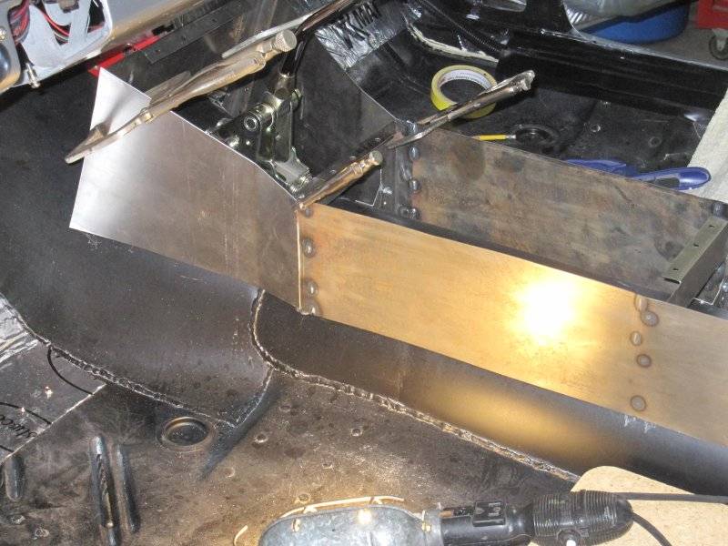

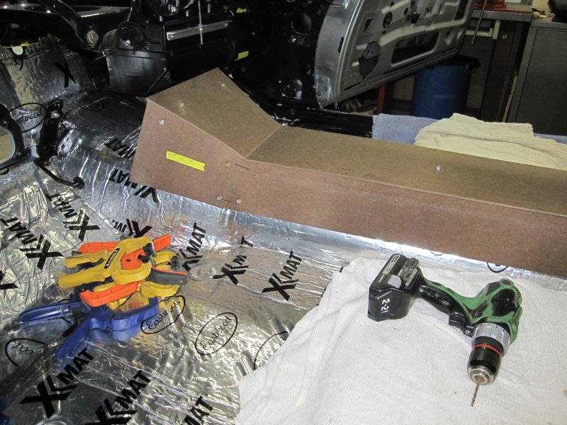

I have built 2 consoles for myself. One wood and one steel. Cup holders are available at marine stores and online. Start a self-made console with a cardboard model. I liked the 1/2" MDF board to work with for the wood unit. My wife sewed up the blue vinyl cover for me and for the steel console I used 1/8" "masonite" attached to the frame with door panel clips. That way the upholstery can be done on each panel and just popped on when done. I am having the sides carpeted and the top and storage box/armrest covered in the same vinyl as the headliner.
