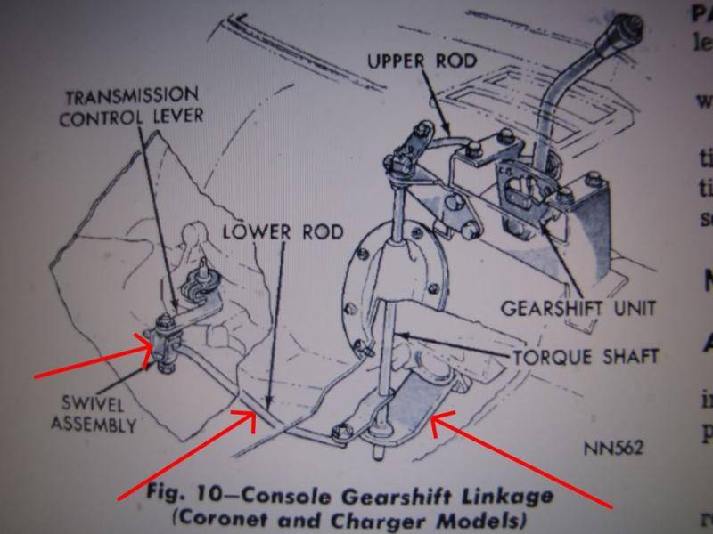

The rooster comb in the trans should click-in.... nothing in the console shifter really does (in 1st). Shifter detents or ridges are to prevent you from doing something wrong, such as pulling down from second to first....nothing wrong with going from first to second.... this is why the ridges are felt in the shifter only certain ways.
From the service manual.
Button push requires to go down. No button, feel the clicks, to move up.
