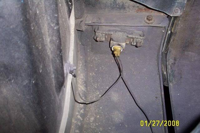

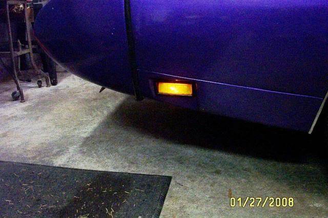

I did mine....used the part that bulb goes into from lighted style, cut square hole in 69 housing and glued both together...lighted 69 reflector
