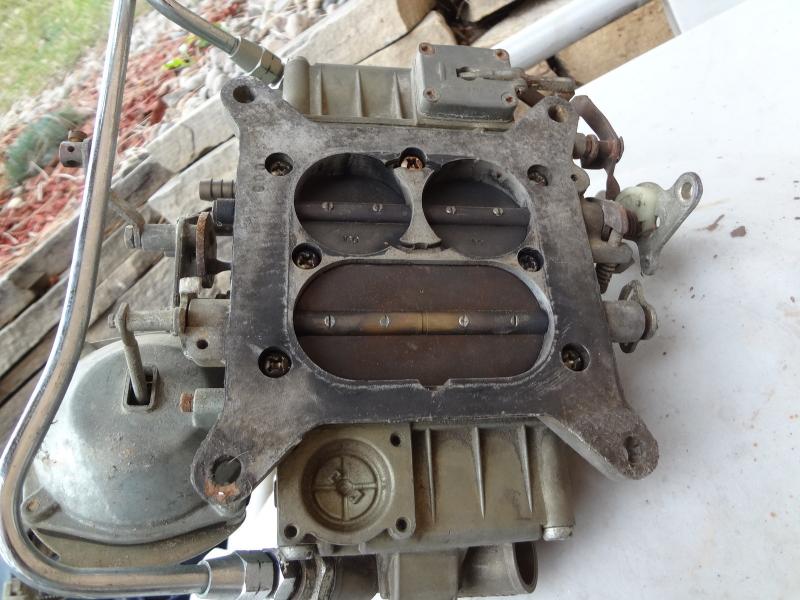

A 3 bbl carb? whats that look like? or was that a miss print?
Holley did indeed sell a 3 bbl carb. Two regular primary barrels and a huge oval secondary.

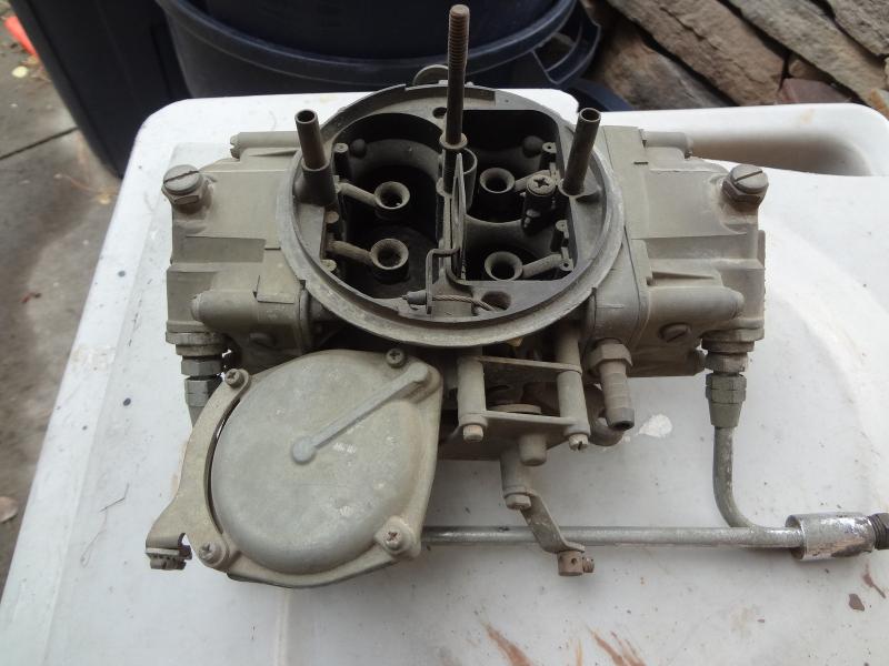

No misprint. Here's the carb. They came dealer installed on cars like Baldwin Motion, Nickey, Mr Norm and the like.

I have a question for you Rat. Why the three barrel? Is it the novelty of it or...?
Mike
I've just always wanted to try one. I have a very nice 3310 750, but honestly, I think with the gear, good quench, ported heads converter and cam it won't hurt to go a little more. Plus, the vacuum secondary should work well with the automatic. I've done a lot of reading about the three barrels and found nothing but they were badass. I gotta try one.

The 108 LSA cam will most likely want the high stall so me thinks you are on the right track. I had a 4 spd behind my 383 and it was a hoot! Pretty much spent my youth getting sideways in first and second and watching my buddies reaching for whatever they can grab onto. The 3 BBL might be a bit much but you won't know until you try. I ran a 700 DP. I have an NOS 1030 3 BBL but have nothing to try it out on - yet. The 472 hemi might like it.
I plan on deckin it out with a quick fuel adjustable secondary diaphragm. That should help.
