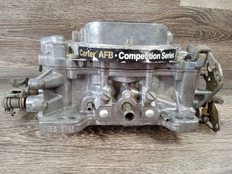

I would use the 750 Carter & keep the Holley for a door stop.
The sec operation of the Carter is ingenious [ which is why Edel copied it ] , unchanged since it's 1957 intro. Unknown & [ misunderstood ] by many, the AFB is a mechanical sec carb. When the pedal is pushed to WOT, all four barrels go to WOT. Because of the velocity valves in the sec bores, air flow is blocked so that no flat spot occurs with the sudden opening of the t/blades. There is a 'starter' or low speed cct built into the sec venturiis that gets initial fuel flowing so that once air speed is high enough to pull the v/valves to the open position, there is a seemless transition to the main cct.
I'd use the vacuum operated Holley and leave the 750 Carter (or "Eddy" equilivant) for a door stop. The Holley will react according to demand imposed....smoothly, without hesitation or stumble.....just my opinion of course....

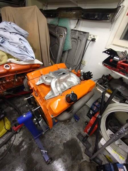

I'm rebuilding the 750 Holley for it. I also decided to buy a performer RPM intake for it.

But I have a CH28 with two 750 Carter race carbs on it and think that is the dog nuts...:thumbsup::thumbsup:
Update: Bought the Performer RPM. Waiting for new valley pan and gaskets. Also needs some orange paint. Should I gasket match the intake or leave it as is? (The heads are gasket matched/ported)

Little update to this. FINALLY got the engine installed and it sounds happy. The dual snorkel air cleaner is definitely NOT going to fit under the hood with this intake. We have a hood with a sixpack scoop so we're going to use that with some performance air cleaner.
Turned out it didn't have the cam I mentioned earlier. It has the Summit SUM-6401 hydraulic flat tappet cam.
Anyways. Here's a taste of it.
