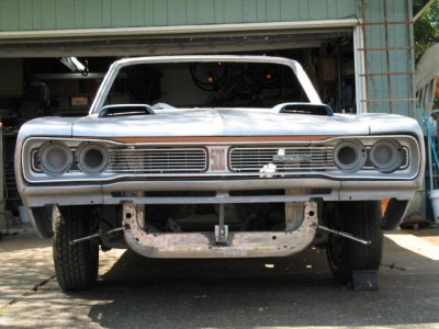

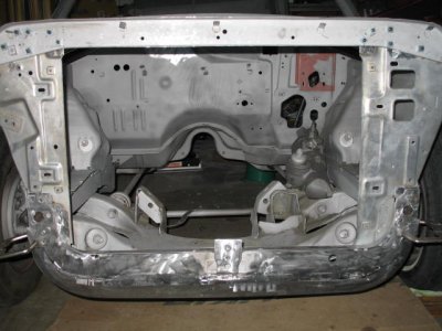

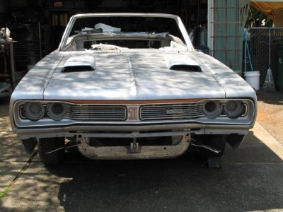

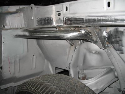

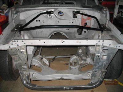

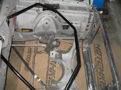

Your absolutley correct on the structural integrity of the unibody when adding more power and pushing the car past it,s origional engineered limits. I will not have any issues with that... I have re engineered the entire chassis to easily handle 500 hp and torque. The car has been given a lower center of gravity, fully connected sub frames, reinforced inner and outer front clip, all side to side body seems fully welded and reinforced, reinforced and re engineered k member, fully reinforced steering box mount, modified and reinforced LCA, strut rods, giant tie rod ends, solid sleeves, geometry corrected UCA, monster drop spindles with 13" Willwoods ,Custom Billstiens, Hotchkiss rear springs, reinforced front spring hangers, billet rear shackles, hotchkiss front and rear swaybars with modified mounts, panhard bar, and last but not least... the fully custom 6 point roll bar installed with ID locking tube clamps for easy removal of all or part of the cage. 500 hp at 5800 480 torq at 4000, Tremec .62 overdrive 5 speed,quicktime scattershield, 410 Trutrac S 60. The car will experience no issues with panel shift or any other torsional issues. I dont plan on professionaly racing it.... I just want it to perform and handle. Formost... keep me and mine safe. Pics are some of the front reinforcments.
Hope to have paint on it by mid June, driving by July.
Wow....!!!!!

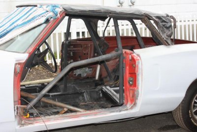

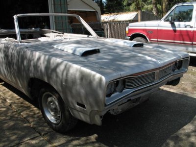

70 Coronet Convertible roll bar
Not sure what look your going for, hope this helps, Not the best picture, can take more if needed :grin:
