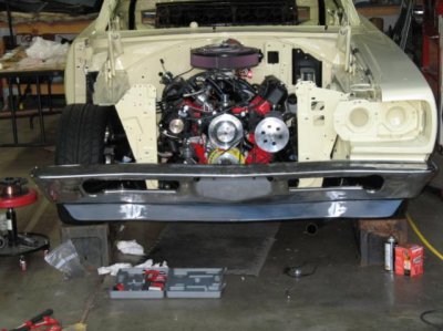

BigBlk Blah Blah Blah{that is way too long of a name dude} That Coronet build is very cool, I love it, Bob C your too, very nice guys...

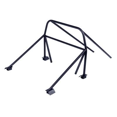

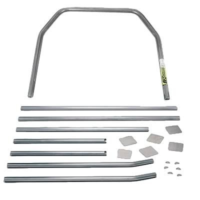

Call Summit Racing or Jegs, Competition Engineering they have just the kit you need you can elimanate what bars you want or don't want... B-Body GTX RR Coronet Charger etc. $199.95

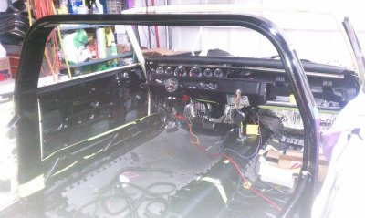

The roll bar in my Coronet will serve its purpose, intending on going to Englishtown when i'm bored. Running a 512 stroker motor, Dana, automatic. The roll bar will be covered with padding and wrapped with custom made covers for the padding. So the pipe look will be tamed a little, while serving it's intended use, to go racing if and when I decide.

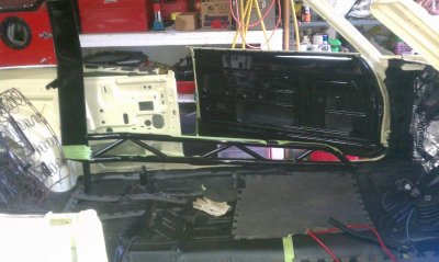

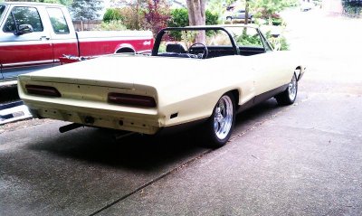

Custom 6 point convertible roll bar
Not sure what look your going for, hope this helps, Not the best picture, can take more if needed :grin:

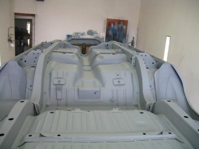

I designed this 6 point cage with function and style in mind. It's attached at both front and rear torque boxes and the rear frame. Full use of rear seat. The rigidity is unreal. I will experience zero panel or window flex issues. I have already driven this think like I stole it for 600 miles and it still makes me shake after I power it through tight corners.... it's on rails and is has very predictable handling qualities.

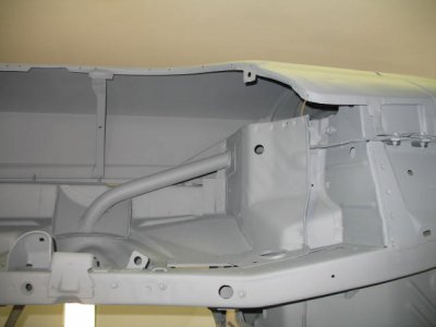

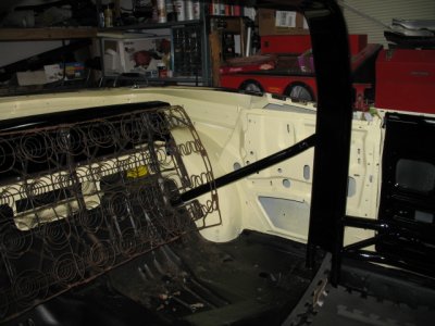

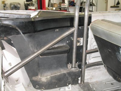

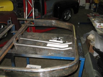

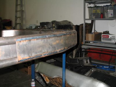

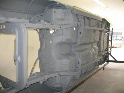

69 CORONET CONVERTIBLE "tiger cage"
The main hoop is twin 1 5/8 DOM tube that has sheet metal fused on with a TIG welder. The front and rear touches are also 1 5/8 DOM. The lattice bracing is 1" DOM. The Cage is engineered to tie in all 4 torque boxes and the rear upper frame. All touches have ID tube clamps welded to 1/4" plate which is welded to the car. The rear touches have front and rear tube clamps so they can be removed to install the rear seat top and kick panels as well as to have the ability to remove the entire cage if so desired. This leaving only short stubs from the floor. Some mods were required on the kick panels to allow the main hoop tubes to be located where the ash tray was. The entire cage was TIG welded and fits very nice. This "TIGER CAGE" makes this Convertible like a 500 HP Go Kart.
The shape of the main hoop mirrors the shape of the windshield frame and disappears when viewing from the front or rear. I didn't want a cage that looked like it didn't belong in the car. Mission accomplished.
