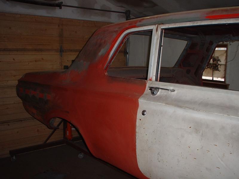

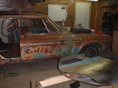

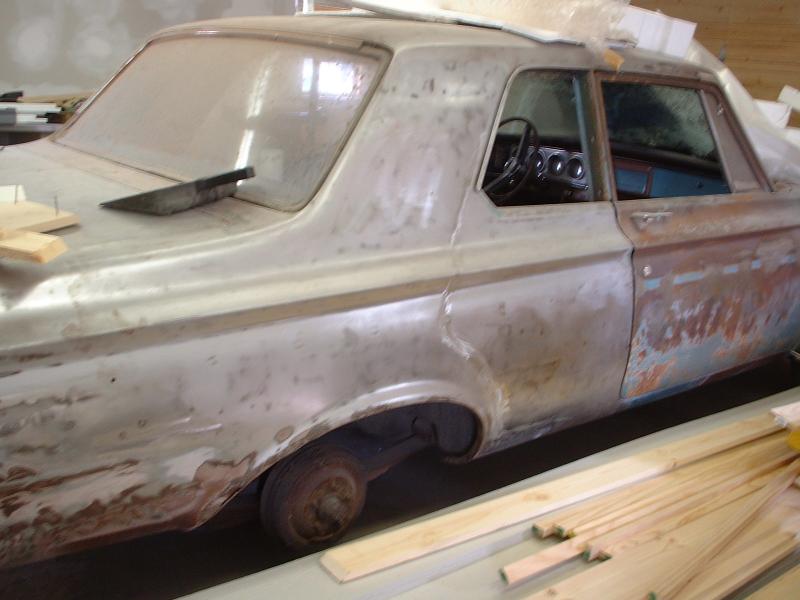

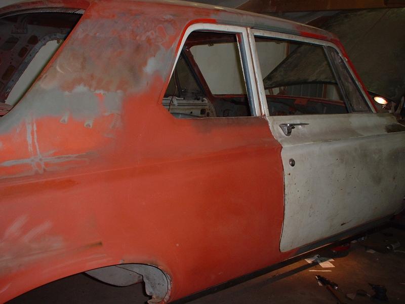

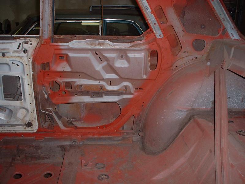

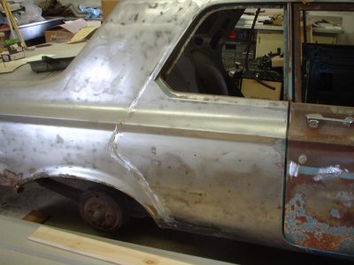

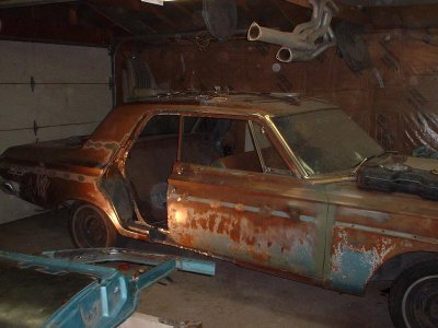

Here's a photo of a 64 fury 4dr that I did 10 years ago , it's now a 64 2dr savoy.
