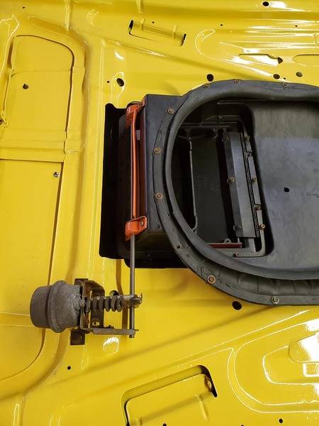

Converting flat hood to Air Grabber
image copied from someone else...might help you see how the door is attached
910870_n.jpg?_nc_cat=103&ccb=2&_nc_sid=b9115d&_nc_ohc=HlNjc-Aoa80AX9hd7DE&_nc_ht=scontent-ort2-2.jpg
image copied from someone else...might help you see how the door is attached View attachment 1057810
It appears to me that the door is attached directly to the duct box.

Correct, the hinge for the door connects to the underhood duct which in turn connects to the fiberglass bubble. The fiberglass bubble supports everything (there is one screw toward the back of the underhood duct that also braces it to the hood)

Anybody done this and taken lots of pictures they'd be willing to share? I bought a repop'd bubble and door but really have never seen any pictures of what the hood looks like without the reinforcement ring installed or how the hinge bolts to the door.
Can anybody help me out?
