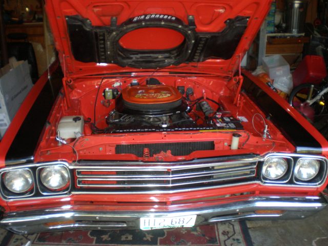

On my '65, I wanted to retain as much of a "stock/unmolested" look as possible. I used the original windshield washer reservoir.

This one is from Mancini--I'm told it looks OEM (though they weren't utilized in '65) mounted on the core support next to the radiator's side tank.

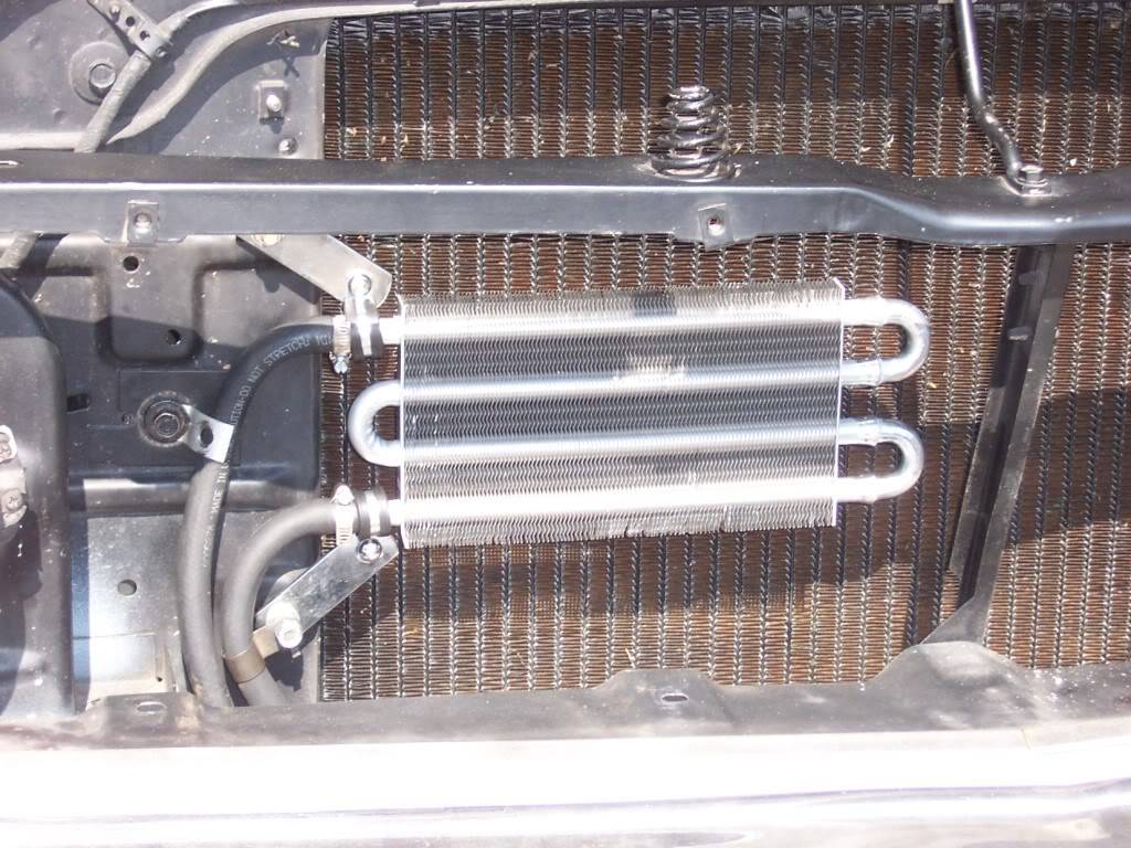

My first choice:
Front right,next to the trans cooler-which I can easily move to the other side. There's slotted holes that accept "T" bolts(what I used for the cooler) to facilitate in mounting. Back in a bit,and I'll let you know what transpires.
