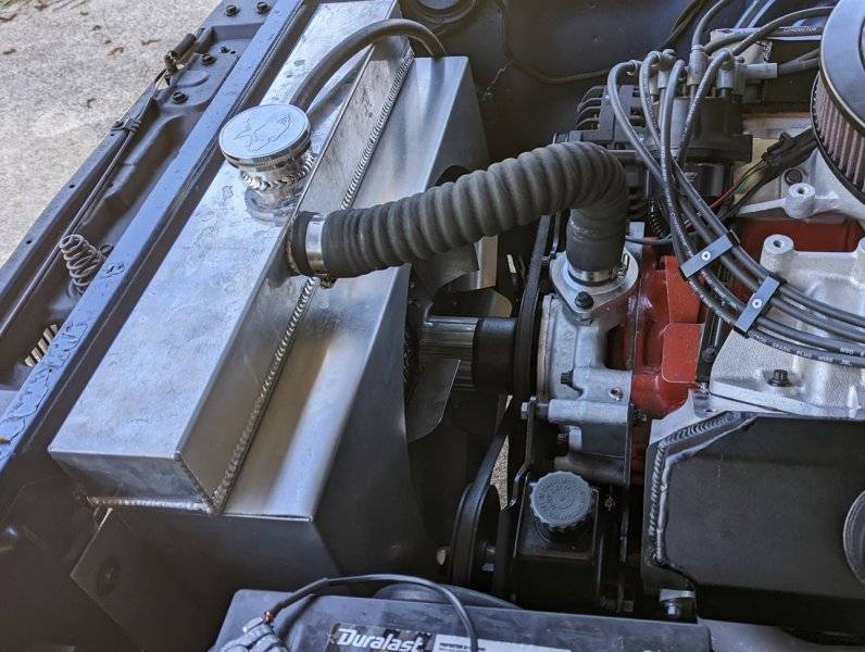

Here are some pics. You can se the fan, shroud, and front pusher. The fan is about 1/2 from the edge of the shroud, about half way in, about 7/8's from the radiator.

If it steadies out at 215-220ish and doesn't keep climbing, you're OK. Do we like seeing it, no. Get rid of that aluminum shroud n fan, get an 18-19" direct drive 7 blade fan. Get a repop factory plastic shroud that has curves, is molded. I'm running 496" 610hp/670tq in 120°+ AZ heat w a/c. 19" direct drive fan w factory shroud. Highway 176-185°, after 30+ minutes of Highway, pull into parking lot and let sit running w a/c on for 10 minutes, temp climbed to 222° and not any higher. Still shows at higher end of normal on factory gauge.
Several things pop out at me.
1-Have you verified the temperature readings you are getting are accurate?
2-Belt tension? It looks deep in the alternator pulley groove. Is it slipping?
3-Radiator size. You should have a 26 inch core if you are making that much HP.
4-Fan, I hate flex fans. I doubt that fan is pulling enough air.
5-Timing what timing are you running at idle and low speeds?
6-Was that radiator designed to cool that much HP.?
Amazing... ok. I will say this, I looked for a repo factory shroud and couldn't find one... AT ALL... I call everywhere and several junkyards. So I made one.
Your tapping into my other thought... my fan might be too small.
