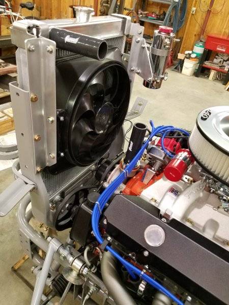

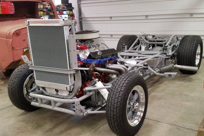

On a freshly built 440.
2 core (1" tubes) aluminum
radiator, 3800 cfm electric
fan w/shroud, fan driven
trans oil cooler, 185 deg
t-stat.
On a 100 deg day at 4200 ft
in stop and go traffic it rarely
reaches 190 deg. The trick
to running an aluminum
radiator is to add some
"waterwetter". It reduces
the surface tension of the
rad fluid which reacts
differently in aluminum
tubes.
