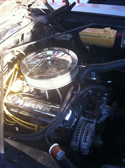

I have a 73 Dodge Charger with a 318, currently a 2bbl but thinking of installing a 4bbl since i have all the parts laying around the garage. It constantly seems to overheat. i have a non clutch fan without a shroud. i've read that electric fan is the way to go but it is not a large motor or being dragged just a basic around town weekend car.. any ideas
Also having a hard time finding out the correct vacuum and sensor layout under the hood.. Not sure what is necessary ...
any help would be greatly appreciated...

I would do a search on this board for cooling issues. Electric fans are largely a waste, especially for a stock 318. Things I would look at are shroud, tstat, radiator (are the tubes plugged or oxidized), and flush coolant to see if there is any scale, also, check the timing - too retarded will cause heat.
Your biggest problem is you have no shroud. Think of your cooling system as a water hose. Water comes in the front, travels through it, and exits out the back. Your cooling system works the same way. Air is brought in through the front, passes through the radiator to cool the coolant, then exits out the back cooling the engine directly. For an engine to remain cool, you need both the capillary cooling from the radiator and the direct cooling from fan blown air.
Now think of a sprinkler hose with lots of holes in it. Water comes in the front and sprays out everywhere.... great if you're watering the lawn but sucks if you need to fill a bucket. :) That's the problem you have right now. With the shroud the fan pulls air through the radiator, but without it the air is coming from both sides of the radiator, which is no good for cooling. And the shroud also directs the direct air from the fan to the engine. Without the shroud your fan is blowing air helter skelter throughout the engine bay, which doesn't help cool anything.
The problem with electrics is our cars weren't designed for them, so there is always going to be a trade off between capillary cooling and direct cooling, and there's no way to optimize them both. Depending on your make, model, and engine, some guys do have success, but many don't.
Your best bet is to get the right sized radiator, a shroud, and a clutch fan.

Spacer and fan position to the shroud are critical for proper air flow (bruzilla is 100% on the mark). The fan should be an inch or so from the face of the radiator and stick out beyond the edge of the shroud for maximum efficiency.

the motor is out of an 86 diplomat, roller rockers roller cam, 2bbl. i think i will look at clutch fan and radiator and tstat out the box. i believe i have a spacer somewhere from the engine swap 8 years ago. Thank you guys.. i appreciate it.. although i got it running again i never trusted it to drive farther then 1-2 hours from home now that i am able to take alittle time on it i want to make a dependable car. i do want to upgrade 2 4bbl but i read that i would want the 360 4bbl intake and not a 318 4bbl intake due to the chambers under carb clogging up..
