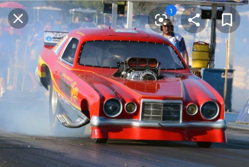

Help me remember. They had a sport charger, which was just like the RR, and then they had the charger XE which was identical to a Cordoba. Had a local racer with a "Charger funny car" was a Cordoba.

I don’t remember a funny car version of these cars being sold or professionally used. While it would be a lot of work, it’s nothing that time, talent and bags of money couldn’t fix.

Ever seen the Nascars? lol Thats when Petty bailed for GM. They tried furys, magnums, etc. If i recall there is a quote somewhere about him saying it was literally the worst race car he had ever driven.

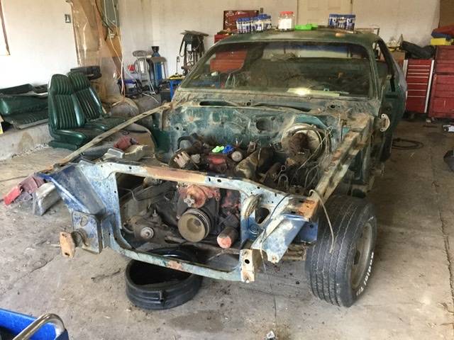

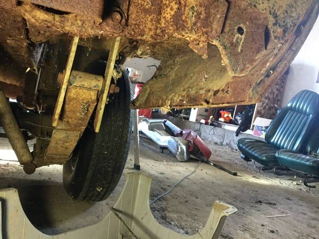

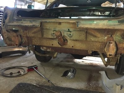

Got a little more done, motor ready to come out. Rear bumper off and found some rust repairs to do.
