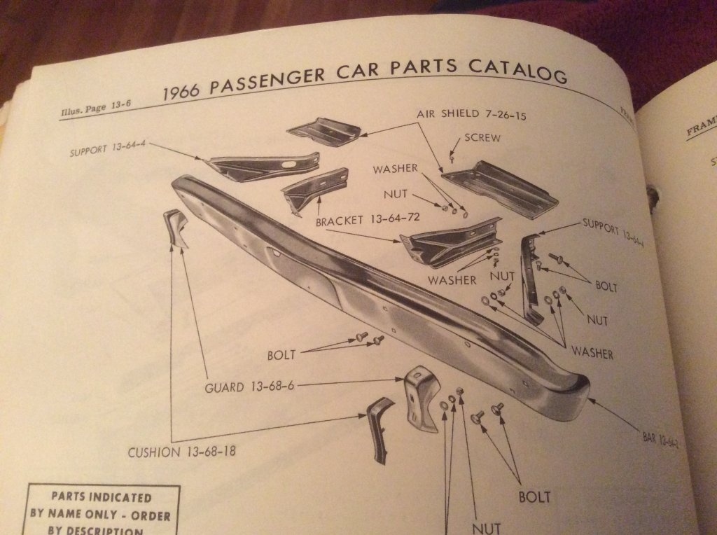

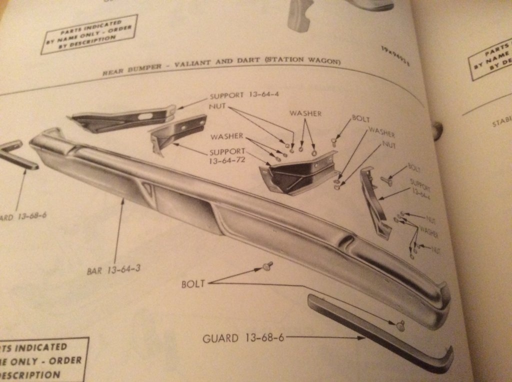

MIGHT fit but not the same. Plymouth Belv or Satell
P/N 2533425 Coronet 2533475. The shape facing body is different. Satellite bumper picture shows optional bumper guards.
P/N 2533425 Coronet 2533475. The shape facing body is different. Satellite bumper picture shows optional bumper guards.View attachment 393382 View attachment 393383
Hmmm...looks like the brackets are at least the same. Looks like the coronet one has a slight bend in the center and the satellite is a little flatter?
