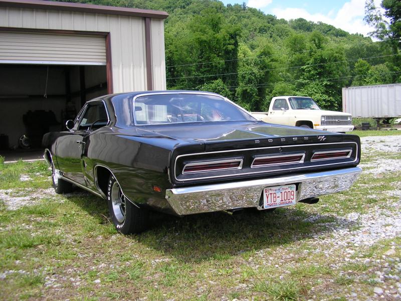

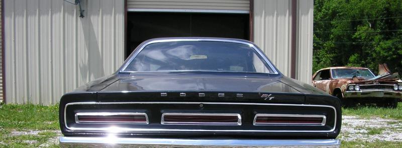

There are a couple significant differences between the '68 and the '69 lids.
Here's a '68:
And a '69:
You can see the '68 lid has a bevel on it and drops down further than the '69.

Lids are pretty much the same on 68 and 69, don't know much about the 70's
The "DODGE" letters on the 68 however were all white inlaid as compared to the painted ones on 69.
If you find one in any condition whatever price is never too much especially if it still has good letters.
