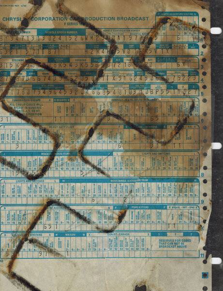

Here is a copy of the build sheet. A seat spring rested right on it. Can you tell?
Thanks
Your tire code (in "BASIC CAR" line-2) is T87 which is F70-14 Raised White Letter.
Your wheel/cover code ("SALES CODES" line-11) is W21 which is Rallye Wheels.
Your WHEELS code ("BUILD CODES" line-4) is (I believe) 61 which is 14 x 6 Rallye Wheels
The only other code in this position that is "(something)&1" is "71" - 15 x 7 Rallye Wheels which doesn't jibe with your tire size.
Since your car had Rallye's or Road's, the "TX9" color code (Black) only applies to the spare tire's wheel.
Your Spare code "16" is a 14 x 6 steel wheel. Since it's a full size spare, I would think it would also be an F70-14 RWL ...same as the other 4, but I'm not positive of that.
Your Wheel Cover code "24" is a 14" Trim Ring Part number 2944424
That's what I come up with. Others may be able to confirm or negate.

Well - crud. Now I'm finding conflicting info (that never happens with decoding, right?!) that 61 and 16 refer to 5.5" wide wheels....
Still looking.
According to Paul Herd's interchange book, these would be 14" x 5.5": part number 2944252 Rallye's, with part no. 2944395 or 3420977 spare on steel. Sorry for the misinfo.
M
Regarding 14” Rallye wheels, the only width available in 70 thru 72 model years was 5.5”. For 73, 6” became available on B-Bodies only. A & E still got 5.5”. The 5.5” got F70 and 6” got G70 tires.
