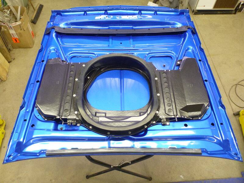

Restoring the ram charger intake system for my 69 super bee. I know they’re black but is there a specific color or shade of black
Okay.. we'll call it Walnut Brown.. that make you happy! LOL

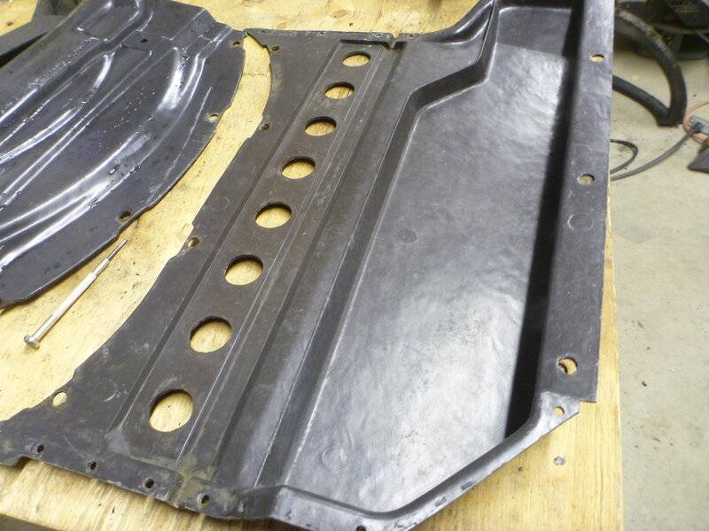

I had my original color matched and it came too brown when we shot everything. I fogged it with some mat black and a heat gun to make it match. I was all full of myself having the color copied and then when it came out of the booth I had a what the hell moment.
Dark Walnut... it matched to what I would call exact against the inside surfaces of the box that had never seen light or engine grease. Same as the heater box.. it's not black either..

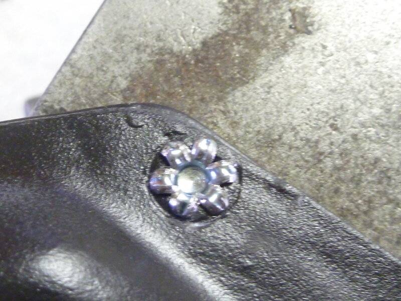

I think the fiberglass strands messed with the paint companies camera for my mix. But to make up for it I made dies to install hollow tube rivets with the claw style rollover and used my arbor press.
Thank you all. So walnut Brown it is or something close.
Dark Walnut. All depends what work you are doing. If the box didn't need repairs it should be a wash and done. If you had to fix crack and paint..yes Dark Walnut is as close as you'll get..
