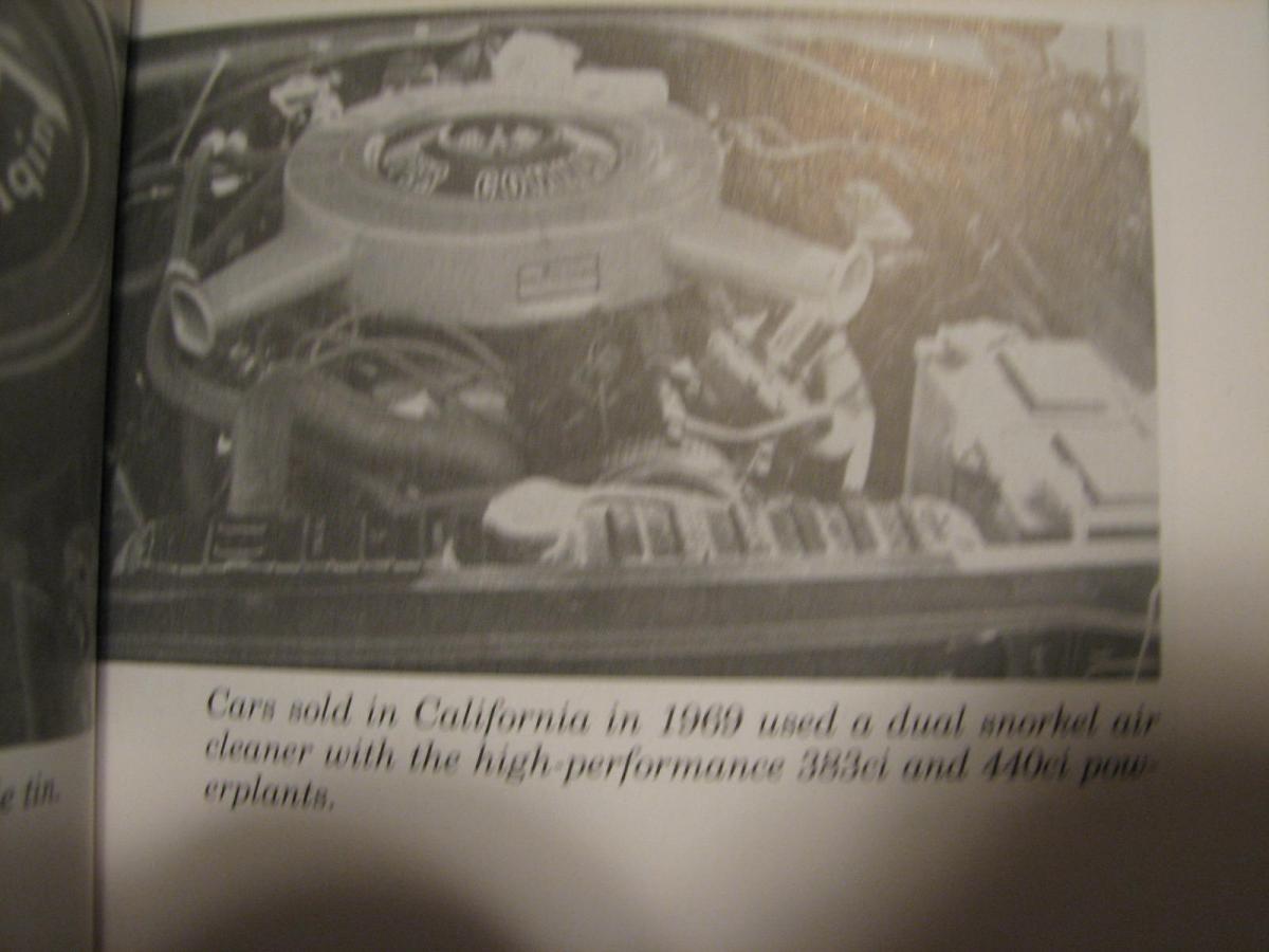

Frog...correct from Paul Herd book. Well, it seems like everyone says it had the dual one...I have not seen that one anywhere for sale. Guess I have to try a junk yard? Any other ideas...besides Goggle?

If you GTX is an A/C car then yes, I believe it should have the twin snorkle. The different pie tins are available repro seperately. If it is not an A/C car then the plans from the factory were for it to have the smaller, round, unsilenced air cleaner which is available repro.

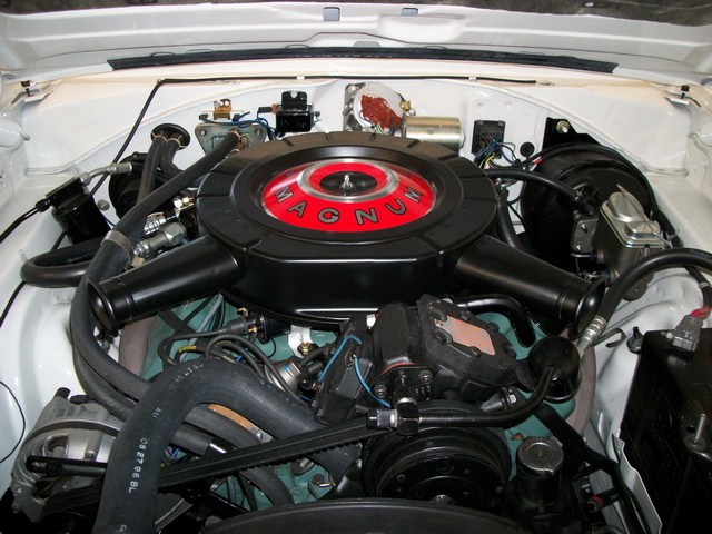

Here's a picture of the dual snorkle air cleaner on my '68 Coronet R/T made in LA.
