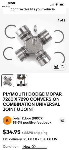

Rather than change the yoke use a combination u-joint. Pinion preload could change. Just a thought.
Not sure ive heard of that? Where do i find?
Is this what you are referring to?
If you go to the website I posted and click on the spicer u-joint and scroll down all the dimensions are there.
Yes, saw that. But i must be missing something… when using this combination u joint, how do the u-bolts fit from the larger driveshaft end to the smaller yoke end?
Straps fit the yoke. Big yoke 7290 small yoke 7260. The straps are different they don't interchange. You have the big straps on your car. You need the correct straps for the small yoke.
Do you have U bolts that have nuts on back of yoke? If you have straps you'll need different straps. I think with U bolts you'll ok. @R413 your thoughts.
Talked with knowledgeable Cass at Dr Diff today…he saud i have a very good chance my existing yoke will fit the just purchased 741 diff. Indicated early 69 489 cases had 10 spline yoke, and the 741 has same.additionally i should just swap the yokes as the 741 case does not have a crush washer, so not to worry about proper tightening. I ordered his pinion seal also.
My reason for not swapping yokes is pinion bearing preload. If yokes interchange the pinion bearing preload may not be right it could be to tight, to loose or just right. Judging by the questions this changing yokes isn't as simple as unbolting yokes and switching them! If you haven't ever done a rear setup you could have a mess by not having right pinion preload. I suggest doing the u-joint swap and buy the straps.
