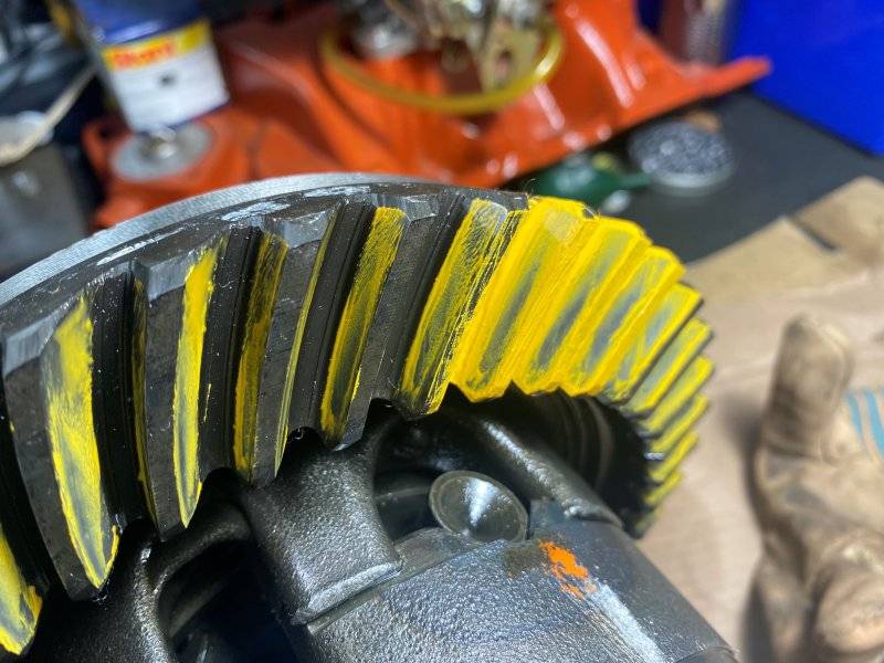

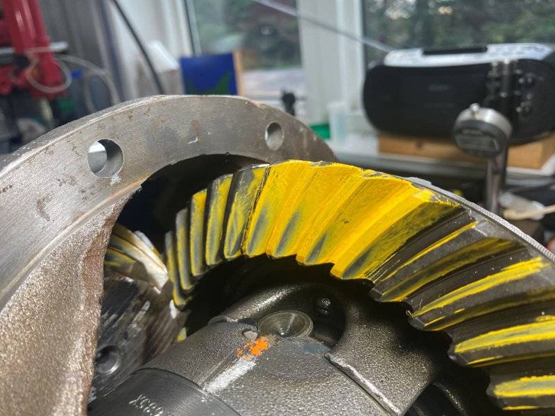

I marked everything with center punch marks. Caps, locks, bearing capture nuts. Everything. Rechecked the backlash, pinion preload, and the gear pattern. Everything seem to come out perfect or at least the same as before I started. I can't believe the comparison on the gear tooth pattern. Almost identical. I'll be putting it together this weekend.
