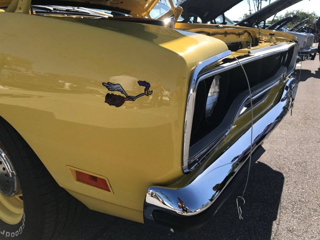

I'm referring to my own Road Runner. The car was painted within the past year or so, but the restorer put the front fender cartoon Road Runner decals too high on the fender. I wanted to reposition them, and add the dust trail striping as well.
My concern is that the bird decal will leave a shadowing, which I could try to 'paint correct' with a buffer. I've included a pic of the misplacement here.

Since your paint is only a year or two old, and the sticker/decal is 3M product, maybe drop into a local sign shop and ask their opinion - after all, they should be the experts.
They may even offer to do it for a box of beer, or less if they are car guys. :thumbsup:
I was just in an auto paint supplier last week (Sherwin-Williams) and hey, there was one of those paint eraser wheels on the rack!
But Anasazi23, why not give it a try on one side. If the worst happens and there's a noticeable outline where the decal was, you can still put a new one back in the same place and you won't be any worse off.
I also see decal remover solution on amazon. I figure I could spray an inconspicuous area and see if there's any paint damage, and if not, try it on the decal. I've also seen some recommend a heat gun to soften it up to be able to pull it off. I'll update you when I get it done in the next couple weeks.
