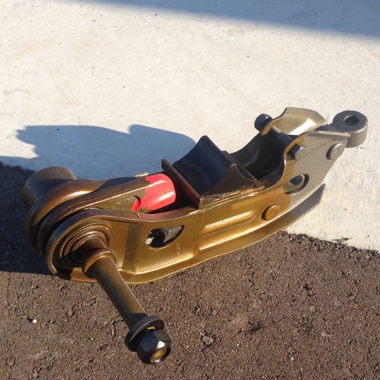

Is this lower control arm indicative of your description? I'm assuming the part that wasn't dipped was left bare.
That's what the arm should look like.

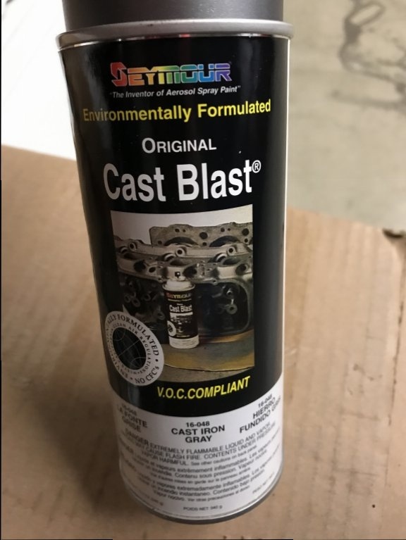

There is a lot of different stages of cast iron. Some areas I used a cast iron gray, some areas I used a silver.
Did you use different shades on your centerlink vs struts?
I used the same shade. The center link and struts I used Seymour Cast Blast, cast iron gray. This is a paint that a shop uses that rebuilds rear axles for semis as well as cars and they sweat by it. It was also the same paint used on my differential. The lca is wear I used the silver.
Thanks. I like the shade that paint gave your parts. I was originally looking for more of a steel paint since those parts are stamped steel, but I may reconsider now.
