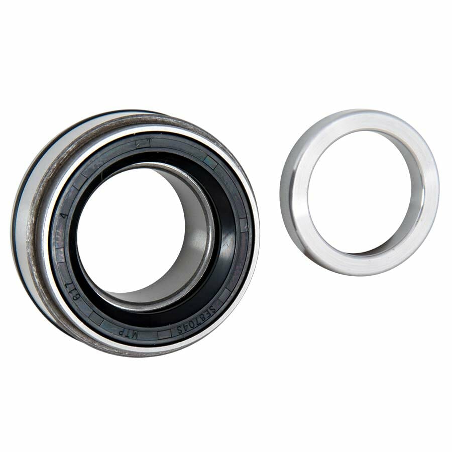

I reiterate my point regarding the AXIAL (cornering) load capabilities of the Green style bearing. It looks like the only way to get any engineering information on the Green bearing's type or manufacturer's part number (all bearings have a manufacturers part number somewhere on the assembly) is to buy one and do my own checking. There are many factors that determine the suitability of a particular type (single row ball, both Conrad type and maximum type, double row ball, duplex angular contact, straight roller, spherical roller, and tapered roller designs and the bearing's internal clearances, eg. Class 2, Class 3, etc.). These factors include: position, temperature, RPM, axial load and radial load capabilities, sealed or shielded or both, method of installation, any preloaded conditions, etc.
Does one type of bearing satisfy all conditions: NO. The application must be based many conditions including cost, L-10 life expectancy, safety, availablity, ease of installation etc.
I'll do my own due diligence with regard to retro fit parts for my applications rather than some other person's opinion, especially the "my buddy" rule or other unsubstantiated information. Just my opinion of course.
BOB RENTON
se8704s is the bearing part number
THANK YOU FOR THE INFORMATION.....BUT....I COULDN'T GET A CROSS REFERENCE ON THE NTN SOFTWARE TO CROSS IT OVER......I'LL KEEP LOOKING....
BOB RENTON
thanks. I am putting the mo400 style in my 66. It'd be nice to know some info. Strange stocks that part but calls it "ford small"
Part Number: A1023A
Sealed Ball Bearing
– 2.834″ OD x 1.562″ ID
– Outer seal & o-ring eliminates inner axle seal
– Includes locking collar
the timkn style list the size:

maybe that number is the seal itself?:wetting:
Part Number: A1023A
Sealed Ball Bearing

THANK YOU FOR HELP AND INFORMATION. My purpose of the exercise is to see the maximum RADIAL and AXIAL load carrying capacity at a rated rpm and temp compared to the Timken bearing assembly as origionality installed under identical conditions, to either prove or disprove the application. There is sbout a 50% faction that believes in their use.....Im one of 50% faction that does not. I cannot seem to get any accurate ENGINEERING information from Dr Diff on how this bearing was selected....so I decided to look for my self. True, ball bearings have both axial and radial load capacity but how much compared to a true tapered roller bearing operating under the same conditions. The small external snap ring on the Green bearing does not appear to be very substantial but without additional information about the bearing assembly, it's difficult to say.....thanks again for the info......

I am doing a rear disc brake conversion on my 70 Charger. I bought the Right Stuff rear disc brake kit. I also ordered the green bearings to replace the factory tapered roller bearings . I noticed that the green bearings come with a spacer,and I am assuming that the spacer goes on the axle first, then the retaining plate,then the bearing with the snap ring towards the hub of the axle. Am I assuming correctly? I am going to take the axles to have the green bearings pressed on,and I want to install them correctly the first time! The axle is a Dana 60. Thanks Pete,
The collar is to lock the bearing on the axle. Old time mechanics call it a wedding ring. My main advice is that you install the ring correctly, it must be heated, before pushing it on against the bearing. If you don't heat it, it may distort and not hold the bearing in place properly. The ring is a onetime use device, if you press it off it is junk do not try and reuse it.
