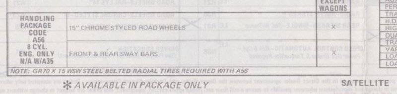

So do you think that these wheels were standard with the GTX package or a GTX buyer would still have to check the A56 option?
I haven't in my many many years , hence my post about them only being available on C bodies. I have seen them on later B bodies such as the Cordoba and charger SE but not on pre 75 b bodiesI see what the book says, I'm just saying I've never personally seen them actually equipped that way.

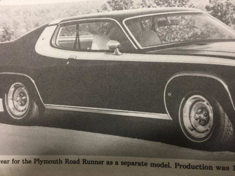

Very nice color combo. That red and white interior is called Wimbledon interior. My 74 400 car That I recently sold had Wimbledon interior and was black with red stripes and the styled Road wheelsYes, I almost purchased a 74 RR GTX that had these wheels on it. That is why I did the research on the subject. It was white with red stripes and the white and red sundance interior. Awesome car, we just couldn't agree an a price.
What specific items do you think that the "handling package" consisted of?Widely debated...but I have never seen anything from the factory that shows a "GTX package" in the traditional sense (code A12, A13, A47, A57, A87, etc) that a customer could actually order. The only factory reference I can find in '74 is in the description of the RR in the data book (basically a passing reference to the RR getting the GTX nameplate when the 440 was ordered). I don't see anything on the 74 Satellite order sheet that shows an orderable 'GTX package' per se.
I have one 74 Road Runner 440 window sticker. I believe it to be a bad remake so I don't think it is a good resource for factory documentation. (anyone have a legit RM21U4* window sticker or BS to share???)
Having said that...I don't believe the A56 would be included with the 440 so it would be a separate option.
all of the 73-74 road runner GTX's that I have seen has had the front and rear sway bars, heavy duty rear leaf springs (7 leaves on right, 6 on left), and torque boxes. Kind of sounds like a package car.Those items are listed in post 20.
