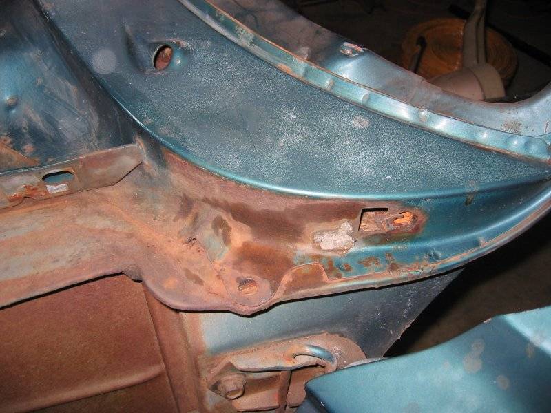

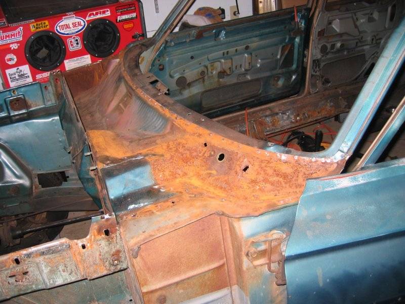

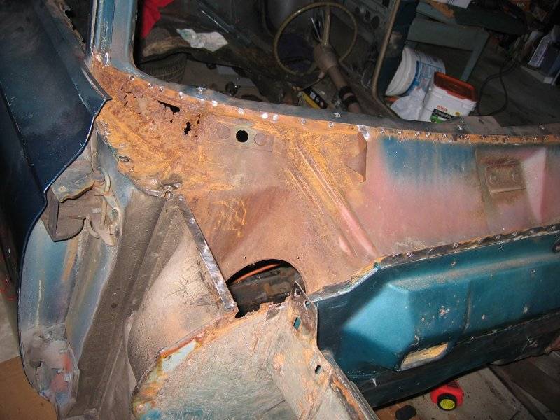

I removed my cowl on my 65 Belvedere to patch it on both sides. Yes - you need to remove the doors, hood and fenders to get at all of the spot welds holding the cowl on. Spot welds all along the bottom windshield frame, the firewall and inner fenders.
And as mentioned above, the lower cowl will need some TLC also, because that was not well rust protected by Mother Mopar and if there are holes there, water will leak under the dash and into the cabin. For me it was a must do - I hate rust.

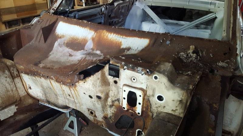

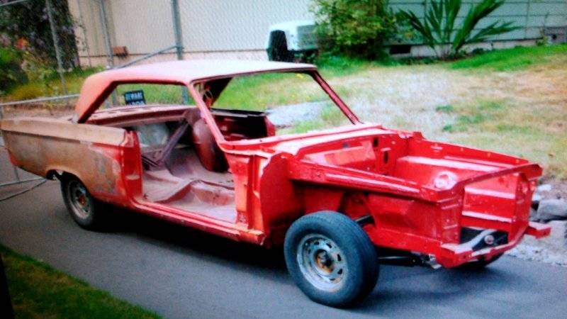

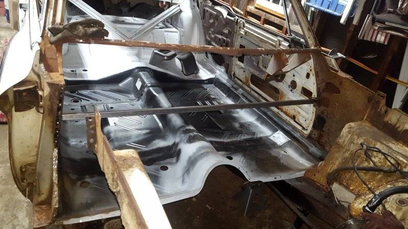

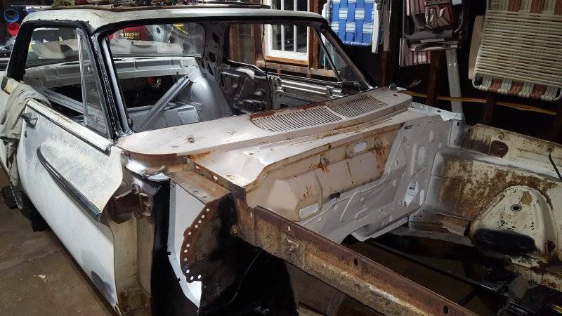

On my 62, I replaced the upper cowl, all 3 pieces, lower cowl, and the firewall, without removing the doors.
I still have an extra rust free lower cowl and my old upper.
Also replaced the floors, torsion bar crossmember, frame sections, uca mounts.
Removed the hood, fenders, windshield, and dash.
First time I ever picked up a welder. I would do it again, but not pay someone, lots of hours.

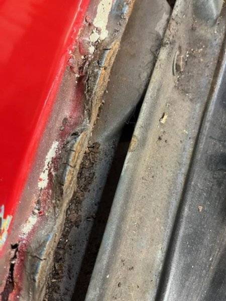

THIS was my "surprise" when replacing the windshield! No rust on my cowl but as everyone else mentioned what LURKS hidden underneath. LUCKILY my "go to" guy was able to hand fabricate new metal so the glass would sit in and seal otherwise a regular glass shop usually cannot do fab work. Boy was I lucky...instead of S.O.L. :lowdown:

Mine 'looked' OK before I removed the top cowl. My windshield channel was near perfect. I knew there were pinholes in top cowl but I didn't think it was that bad underneath. Underside of top cowl was pitted badly also. I'm OCD with rust so it had to come off.
After looking at my pictures again, Matthon, I stand corrected. You don’t need to remove the doors to remove the cowl. But to do any bodywork / patchwork in that area where the doors and cowl meet, the doors really need to come off - or you risk damaging the doors.
FYI, if you need to align the doors, now is the time to do it, ask me how I know!
You should really check the alignment of the doors and door glass, and adjust both, when the fenders are off.
It seems the rust you can see is 30% of what's there.

First time I ever picked up a welder, and if it wasn't for fbbo I would not have got through it.
There's an entire thread of me asking if replacing a firewall is even a thing, or possible.
The good news is, it was worse than it looks.
It wasn't what I had in mind either, however, saving this car was in my mind, without farming it out, so I had no choice.

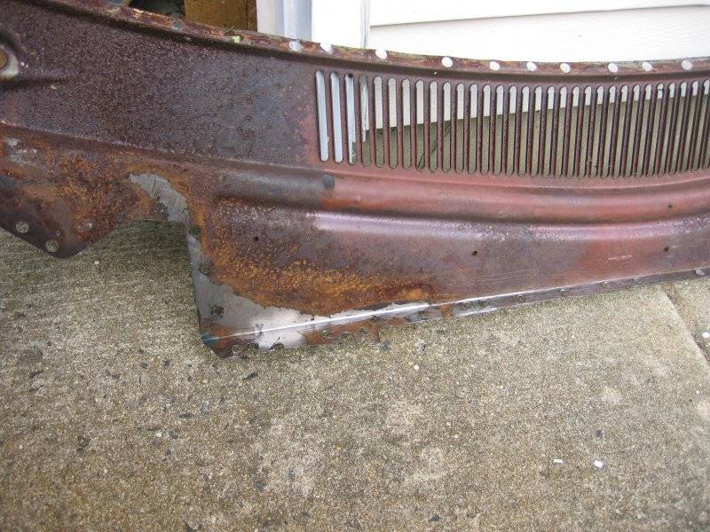

Having had my 63 inner completely ate through I can tell the OP if the outer cowl panel looks that bad the inner will be worse.
The inners only got the overspray from when the outer was painted. Once the drain holes got clogged up (few years down the road) they were on there way to rotting out.
