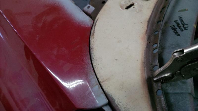

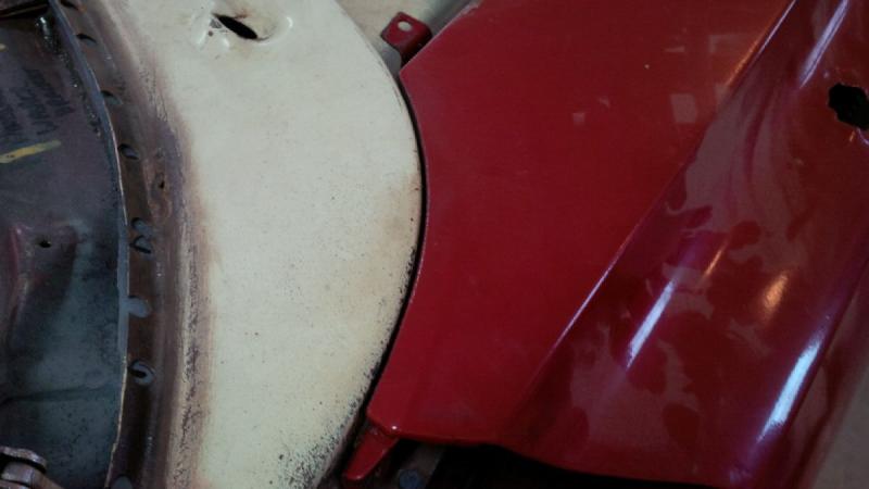

Had to replace upper cowl used donor. Test fitting fenders as pictured. Can someone tell me if this gap is enough, looks ok to me.... wondering if it should be a little wider.... would you guys throw doors on as well ?

doors fenders and hood...... its worth the trouble to get it positioned just right........ they all work together
it looks close to my 65 satellite. no more than the thickness of a paint stick line up the doors about the same
that's looks right, because it is a radius if you move it out the outer edges will become an even bigger gap, if all edges along radius are same distance you know you have it right
