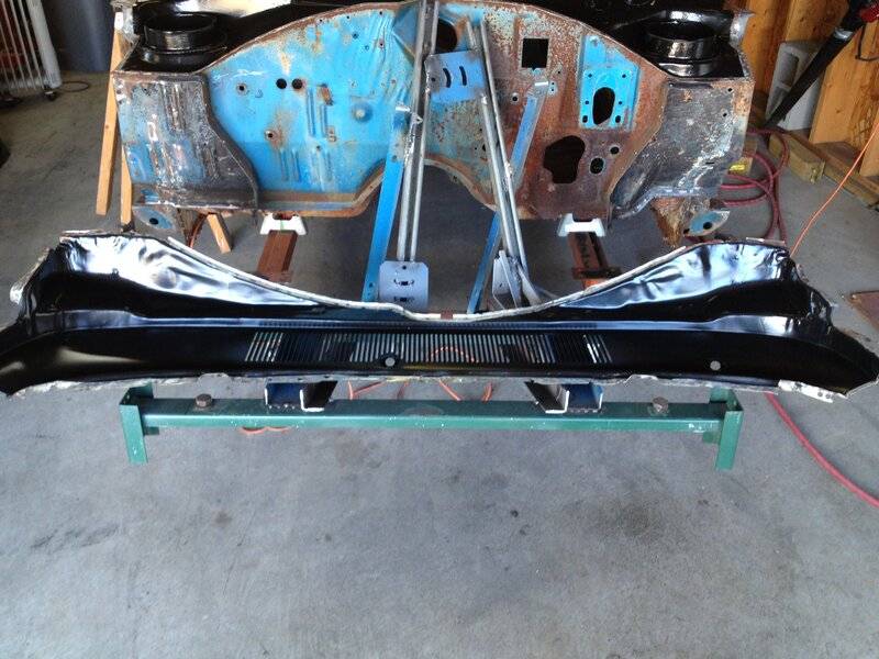

My upper cowl has been removed. It and the lower cowl have been epoxy primed.
Is the epoxy primer good enough or should It get paint? Maybe with a rattle can?
What Should I use? Something like SEM trim black?
Should the back side of the upper cowl get some kind of dampening material sprayed on it?
Like undercoating? (With it clamped down, it sounds a little tinny if you knock on it)
Also do they make a weldable seam sealer to go between the upper and lower cowl?
I ask because when I removed the upper cowl there was what looked like seam sealer all along where it had been spot welded.

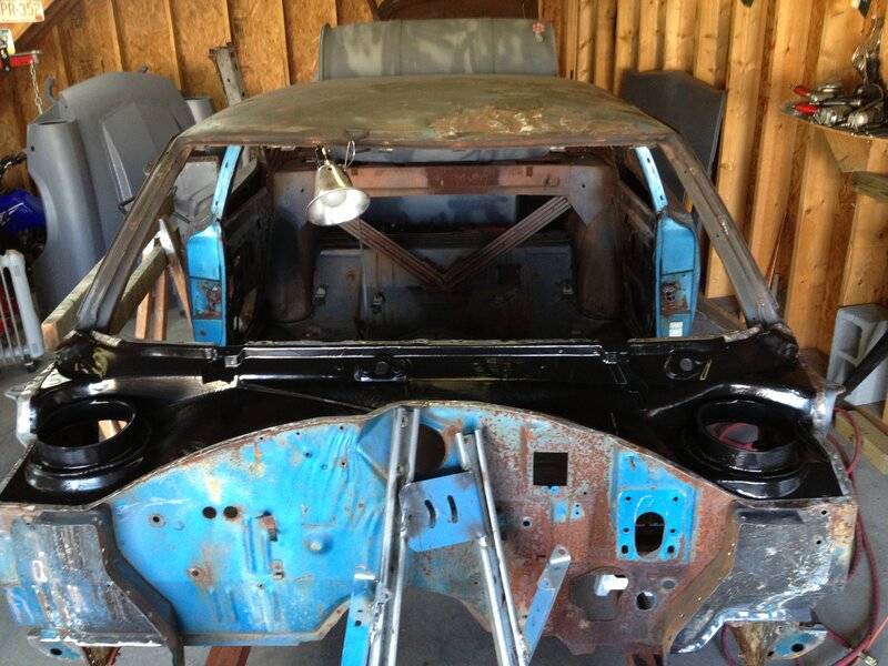

Here is an older pic showing the lower cowl painted with the epoxy
I fiber glassed mine. After the glass was set up good, I brushed Rust Oleum gloss black paint on top of it. Used weld thru primer when reinstalling outer cowl.
Mike
I epoxied and then used Chassis black so it was durable and when you look through cowl it was dark. No need to seamseal as the ends are open anyway.
I really like the result.

When I removed mine it appeared that they used something that expanded, looked like foamy seam sealer that could be welded through? I epoxied mine, painted it black then removed enough paint around the spot weld areas to weld it and used weld through primer. Once done I worked through the vent opening from the inside with multiple angle sticks and butchered up brushes to seam seal the joints PITA!!
Another tip, I investigated my car to find points of entrance for rodents. I'm certain the drain holes on the outside of the cowl is the gateway and riveted stainless expanded metal over them, I've never had a mouse in my car.
