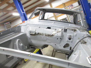

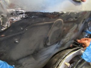

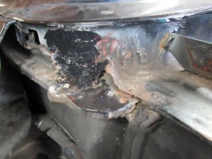

Under the cowl plate, is a common area for bad rust, mostly at the driver's side end, for 62-65s B-bodies.
Mine was bad enough, I pulled the entire plate. Had to repair rusted out area.
Hopefully nothing rusted through. That was the start of a 2 year adventure on mine!
Rust check or a converter like ospho but then it will need to be flushed with water i think and then painted ot protected with some other coating.

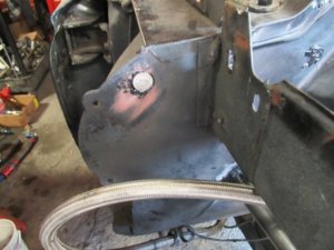

Drivers side got a repair patch.Passenger side on the vertical side is shitty,and I'm no show Queen,LOL
