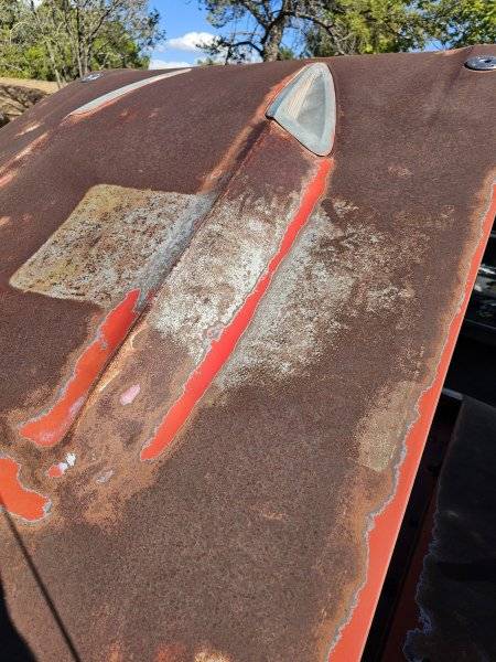

Surface rust?
Any type of mechanical sander/grinder will NOT get all the rust pits out, it may be good to get the worst of it off and then use Evaporust or a rust converter. Be very carefull not to build up too much heat and dig too deep or the whole panel will be as wavy as the ocean.

Smalll areas sure, you can dig the rust out but not when the whole panel is that heavily rusted.
So, a cup brush, dust mask, and a lot of nasty dust, then a little evaporust...... Or, a few terry towels, some Evaporust & a little time...
I grew up farming, a cloud of dust from this is meaningless in my world. Takes A LOT less evaporust product if you start this way too.

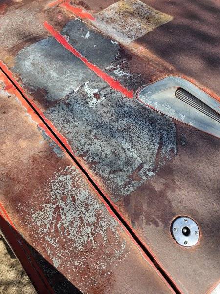

I disagree.... I've used evaporust on similar rust.... I used a couple terry towels, laid them over the rust then poured Evaporust on the towels... Re-wetting them every couple hours.... It did a great job...
I tried some evaporust on a couple of small towels just to see what it would do. Not a whole lot of time but seems to work pretty good so far.

Tried the kleenex strip and WOW, just left it for a few hours and much better than evaporust.
Glad it's working for you! You have some heavy surface rust there.
Yup, good thing it's been here in new Mexico it's whole life or there would be nothing left. Lol. The one square that I have done twice came out great. Will see how the rest turns out before hood shopping.
The reason Kleen Strip works so well is it's Phosphoric acid... So unlike the Evaporust if you aren't careful it will do more damage... It needs to be sealed or be neutralized to prevent further (actually more severe) rusting....
