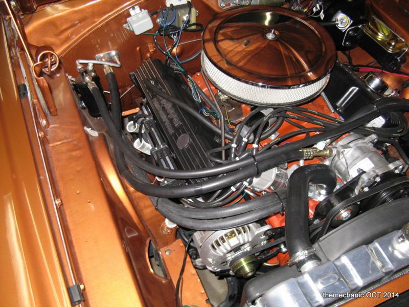

Boy ... I would have lost a lot of money on that bet. What is that braided hose that runs from under the battery to the brake booster?
You could remove the breather on the right side(passenger side) and install a pcv grommet in the valve cover. Then a pcv valve pushes into the grommet and a piece of properly sized hose from the pcv to the proper vacuum port on the carb. Mine is on the rear of the carb at the base. Good luck.

What he said. Should look like this:

So breather on driver side, grommet+pcv hooked to carb on passenger side? Where would I buy that?

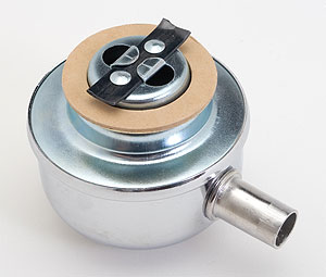

So. I ordered a PCV and a grommet, installed that on the passenger side valve cover, routed a 3/8 hose to the PCV vacuum port on the back side of my holley double pumper and rolled to inspection with a breather on the drivers side valve cover. Guess what? THEY FAILED ME since it's not a closed loop. I asked them what the difference was between having the filter on the valve cover compared to a hose from the valve cover to the air box - but he couldn't answer. I need a hose - else car will not pass.
I hate this country. They allow a 440 cu engine with headers and flow master 40s and I can run w/o winter tires in the winter but they fail this? Don't know what to do now really except buying a new breather with a hose connector and fake it to the air box.

Use this cap Trans Dapt#969-4806s cap Or one similar. You then hook some hose from the cap to a port on the bottom of the air filter.If it doesn't have a port under the air filter, make one.969-4806_2.jpg
