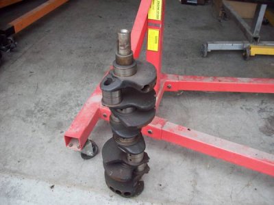

Looking at this ad for a 440 crankshaft, the owner is calling it cast but it sure looks forged with the rounded counterweights. Any thoughts?
By looking at that picture I'd agree with you. Rounded corners and wide parting line.
The counterweights have "v" shaped cuts, isn't that a sign of being internally balanced? Meaning forged. Not an expert by any means.
Should be able to give you a part number, eh?
Hey guys,
I am going to look at it tomorrow and will verify by part number, the parting line sure looks like a forged crank to me too. thanks for the feedback.
Hmmm...
from the pic, its looks cast to me...
but it's hard to tell from pic
Smack it with a wrench,it should ring like a bell. BTW it's forged.
I'd bet 2 beers that it's forged and would be the winner! That thing is as forged as they come.....
I am gonna owe a 12 pak before this is over...:icon_eek:
Yep, forged.

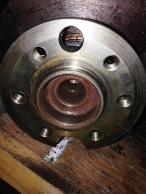

440 forged crankshaft and block
Picked up the crankshaft and it checks out with #2206160, a forged crank. It also appears to be a 4 speed crank, but perhaps all '68' crankshafts were drilled?

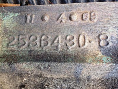

The reason I am saying a '68' crank is because it came from this block.
The heads are #3462346 so proably not original to block and crank.
Now doesn't that have a ring to it, a 68 date correct 440 in my Coronet 440?
