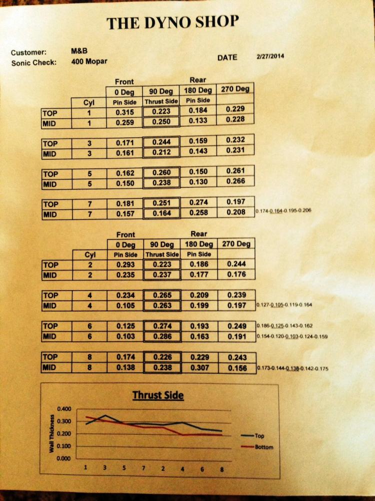

Thanks Meeps, this week I am headed to the machinist to go over sonic test of the 400. Over the phone he said that 2 cylinders were 'thin' if going with a high horsepower build. lI'll drop off the 440 block to be checked then.

400 Sonic test results
Dropped of the 440 for hot tank, mag check & sonic test. The 400 sonic test results are posted below. The suggestion was to keep the build to stock stroke 400 hot street build, a stroker 451 would require a couple of sleeves.
Waiting for the 440 68 block results I should mention that a stock stroke 400 450hp/450tq+ has the edge because I am already setup with 1 7/8 tti headers. But if building the stock stroke 440 is a now brainer I am sure I could sell the low deck tti's?
