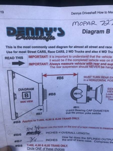

I used Dennys driveshaft PDF to measure the driveshaft for the 71 Satellite followed the instructions and dropped off the shaft to be made from an old C body driveshaft. Well the slip yoke bottoms out in the transmission and I had to take the caps off the rear ujoint to get the driveshaft into the yoke. Its just too damn long but it does fit with no way for the suspension to compress without shoving the trans forward. So I guess I need to have it cut again I assume an 1.5 to 2.0 inches will be good.
If it can be installed you don't want to take 2" off... Max 1.5" probably 1.25"
Did you have a slip yoke prior to making the measurement? Any driveshaft shop I've ever dealt with wanted the measurement from center-to-center of the front and the rear U-joints, with the slip yoke 3/4 to 1 inch from bottoming in the trans. That chart looks to me like they're taking the front measurement right off of the tailshaft case, minus your 3/4" to the end of the shaft?
I looked at a hotrod mag article they used the same dimensions I did for a mustang driveshaft.. Theirs worked out.. Im wondering if the guy who made this drivesaft understood. I was thinking 1.5 inches would be good.
I know somewhere I read that you stick the slip yoke in and pull it out an inch.. I guess you guys are correct I'll have them take 1.25 at most off it.
Might as well not guess this time...without the suspension hanging, set the shaft aside, put the yoke in an inch from bottoming and use the number from center-to-center where the front and rear ujoints will be. Make sure your guy knows how you measured it, you'll be good to go!
At the time i took the measurements I didnt have a slip yoke. I used the measurements asked for by that sheet. I assumed they would know what needed to be done from there. Then I got the driveshaft and slip yoke after. Driveshaft guy couldn't find a 727 slip yoke..
If you measure C to C on u-joints use the trans yoke your measuring with. Had a shaft made from a driveshaft that I didn't want to remove the yoke had 1330 u-joint. Ordered new shaft using C to C of old shaft but with 1350 u-jointed yoke. Well the new yoke was 1/2" bigger and beefier, it was ok but just barely.
